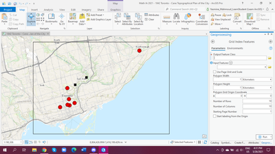

Hi, I'm trying to make a grid that is specifically made of 1km squares. However, there are 2 things I do not understand.
1) Output Feature Class
What does this mean? Can you choose any name? If so, does it affect how the grid will show up? For now I've just been randomly typing things into it.
2) Input Feature
Now this was the real frustrating part. Currently the only features I can select from are the features that represent the red dots and/or the black squares. I can't get a way to tell the system that I want the grid all over the enclosed black frame (I've learned that's a graphic layer and therefore doesn't count as a 'feature', which I don't completely understand, but okay.)
Thus, when I tried to make my grid....
the squares only show up near the red dots/black squares.
I have also tried to make a feature set that has giant black squares essentially covering the area I want, and set it as an input, but that didn't work.
Oh, and you know the little grid icon at the map's bottom? I tried setting that to 1km squares too, but those squares don't even show up at all. Invisible. Even when I zoom in. And yes I have checked the colour settings. Only when it's in 32 ft or something, then it shows, but that wouldn't work for my project.
I have no idea what I'm doing wrong. Please help me; I've spent hours looking up tutorials but they seem to use a different format of Arcgis Pro or they don't explain thoroughly to me. Your help is appreciated.

What is your projection?  (it should be a projected coordinate system and not Web Mercator)
Why not create a fishnet as a polyline if you just want the outline of the grids

I don't quite understand what you mean by 'projection'; please explain? But I shall try the fishnet.
"it should be a projected coordinate system and not Web Mercator" --> If you mean that I should have obtained the map from the program and not import the map from an external source, then that's what I did; the map is courtesy of Arcgis.

Ah. You are very new to GIS.
So, "Feature Classes" are the new type of file that stores/displays some geographic feature.  In your case, those are the layers you've named "dot," "okay," "sites," etc.  Usually a feature class contains things like "water fountain locations" or "roads."  Besides the graphical depiction of the locations, feature classes also contain an attribute table that store all sorts of values attributed to a particular feature.
It doesn't really matter what you name them.  It'd be best if it is something that makes sense.  I might name a linear feature class of trails in a park "P_Trails" and then create a buffered distance polygon feature class from the trails called "P_Trails_bffr30ft."  ArcGIS starts acting broken if you have any spaces in the path name or file name, so it's just best to avoid spaces.
"Projection" refers to the crazy math used to take what is an oblate spheroid (the planet earth) and display it in a 2-dimensional form (a map, or the PC screen).  Thankfully, very few of us actually have to deal with the math.  The default projection of ESRI Online maps use the "Web Mercator Auxiliary Sphere" spatial reference (also known as WKID 102100).  Here's ESRI's intro to the topis for ArcPro: https://pro.arcgis.com/en/pro-app/latest/help/mapping/properties/coordinate-systems-and-projections....
What you'll want to do is Reproject whatever Feature Classes will be involved in your analysis, as well as change the Map's projection.  https://pro.arcgis.com/en/pro-app/latest/tool-reference/data-management/project.htm
Here's the list of Projected Coordinate Systems: https://pro.arcgis.com/en/pro-app/latest/help/mapping/properties/list-of-supported-map-projections.h...
You should choose one that's best for your project.  I'm partial to Albers.  Albers Equal Area Conformal Conic, USGS Version is used a lot in my office.
~So then, create a Fishnet, or Tessellation.
Also, you might want to create a new Feature Class, as a Polygon, and use the Edit tab to add it to your map as a substitute for that purely graphic black frame.

You are right about the graphics layer. So first thing is we will create a shapefile or feature class, and draw a polygon on top of the graphics rectangle.
1. In Catalog pane > navigate to your project folder > right-click the File Geodatabase (*.gdb) > New > Feature Class.
Click Next until you reach Spatial Reference dialog. Ensure a coordinate system is selected/available (see screenshot below). Click Finish.
The feature class is created (currently it's blank), and added to Content pane.
2. Now let's create a polygon on top of the graphics, shall we?
Ensure the "Area of Interest" and the graphics layer are only checked in Contents pane. Uncheck the other layers.
Click on Edit tab > Create
In Create Features pane, select the Area of Interest layer > Select Rectangle icon.
When prompted to save all edits, click Yes.
3. You may run Grid Index Features.
