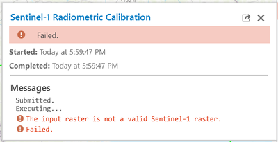

I am trying to process Sentinel-1 data in ArcGIS Pro. I am downloading the data from the Copernicus Open Access Hub. I am specifically downloading this SAR data (clicking the link will download the data - 1.61 GB). I've unzipped the folder and added the folder to my project in ArcGIS Pro. Inside this folder is a folder titled "measurement", which contains two GeoTIFF files with the Sentinel-1 data. I then project the raster on the map with the Project Raster tool.
Now, I'd like to use the Sentinel-1 Radiometric Calibration function (under Raster Functions) on this data, but I get the error shown in the attached image. Any help resolving this issue would be helpful -- thanks!

Tim_McGinnes
Can you try doing the radiometric correction on the original files exactly as they were extracted? It is probably trying to read metadata from some of the other Sentinel files, and when you projected the raster to a new name it can’t find them.
ConnorCozad
Thanks for your response! I tried your suggestion, and that appears to have solved part of the problem. I guess I was getting two errors in my screenshot above. Now, I'm only left with one error, which says "The input raster is not a valid Sentinel-1 raster." It just seems really odd that this file would not be recognized as a valid Sentinel-1 file, since I downloaded it straight from the ESA's data hub.
