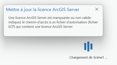

Hi,
I have an ArcGIS Pro project that contains various maps. Each of them have layers coming from an Enterprise Geodatabase (SDE) of our Enterprise.
Since we updated Enterprise, when I open the project, ArcGIS Pro is asking me to put the new licence for ArcGIS Server in a pop-up as the below picture. I have this license, but it's impossible to write it anywhere. The maps/scenes of the project don't appear. It's impossible to close de pop-up despite the little cross in the corner, and also impossible to close the project. Everything looks frozen until I put this license, but where ??
George_Thompson
Esri Notable Contributor
You need to connect the Enterprise Geodatabase as SDE and update the license. This message is usually when the license expires in the geodatabase. We also have a GP tool to do this: https://pro.arcgis.com/en/pro-app/latest/tool-reference/data-management/update-enterprise-geodatabas...
This should get you going.....
--- George T.
George_Thompson
--- George T.
mmarkovic
It worked with the geoprocessing tool, thank you !
