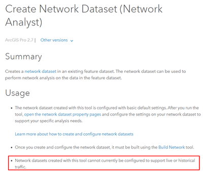

I am stuck in with making the network dataset - using traffic option in properties.
It keeps showing the message "The network dataset was not created to support traffic"

Dear Stella,
After searching I found this
So I suggest you
If you have an old network dataset with traffic data just create template from that network dataset Create Template From Network Dataset (Network Analyst)—ArcGIS Pro | Documentation and then you can create network dataset from template.(Create Network Dataset From Template (Network Analyst)—ArcGIS Pro | Documentation

Does anyone perhaps have a template XML that they could share? I tried to create a template from the Network Analyst Tutorial data (SanFrancisco.gdb/Transportation/Streets_ND), but I got an error about my feature dataset lacking the Restricted Turns layer type. I tried to manually edit the XML, but I wasn't able to get it to work.
Also, does anyone know if Templates created from ArcMap can be used in Pro? Online documentation appears to suggest that historical traffic is only supported in the creation of Network Datasets on ArcMap. I don't currently have it installed on my machine, but if there is compatibility, I could go ahead and discuss my download use-case with my IT department. Of course, I can test this out and provide an update if this goes unseen or the answer is unknown.
