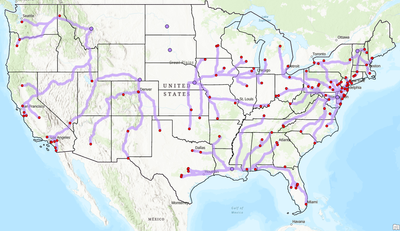

I am trying to find routes from facilities(in my case certain capital cities) to the nearest incident(in my case theme parks).  I have tried running the analysis twice and both time two of the facilities there are no routes.
How can I fix that? Why does it happen?

The Solve operation updates the Status field of both the Facilities and Incident layers as documented here. The codes in these fields will tell you what issues the solver encountered.  Have you checked those Status fields?

Thank you for the assistance.  I have checked the status field on both the Facilities and Incidents and everyone of them say "OK"

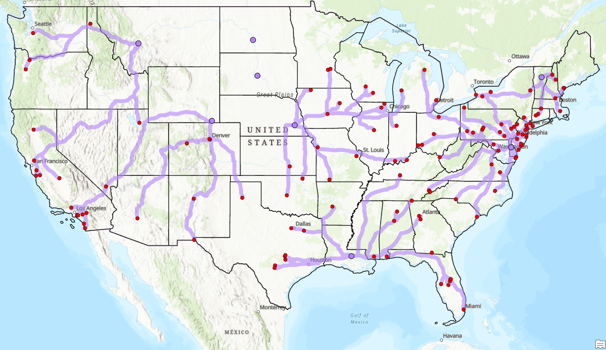

Looking at your map, note that the incidents (small red circles) are assigned to one and only one facility. So the Dakota facilities don't find incidents because they've all be assigned to other facilities.  I suspect your  TargetFacilityCount is 1 (one).  See documentation about TargetFacilityCount and other attributes  here
Instead of using Closest Facility, you might consider using OD Cost Matrix   Your capital cities would be the Origins and theme parks the Destinations.  You can specify number of destinations to find and a cutoff distance.  The only issue with OD Cost Matrix is that it outputs straight lines between the OD pairs.  But I'm sure that there's plenty of posts that show how to create network paths between the OD pairs.
