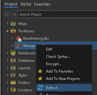

For a Python toolbox (.pyt):
  • in the pyt, reload the imported modules. this will recompile it into the pycache folder
  • refresh the toolbox in Pro. this will make it reread the pycache

For script tools, I'm not sure, try refreshing the toolbox in Pro.

DarrenConly
Thanks Johannes,
I'm using as a script tool in a toolbox (TBX). I've tried refreshing the toolbox but that doesn't seem to fix it either. Might help if in the main script called by the toolbox if I add importlib.reload() for all modules used by the script.
