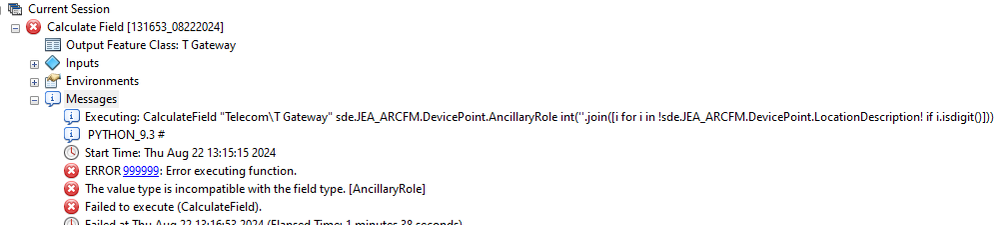

EGardner7
T Gateway error.pngHi Cody thanks for your response. Here is the error message.
CodyPatterson
MVP Regular Contributor
Hey @EGardner7
It may be how you are returning the function, I believe you are trying to return an integer, is the AncillaryRole field an integer field? If it is not, you may try changing the datatype to be a string or similar using the string function str(), you may not even need to use str() as it could be returning as a string already:

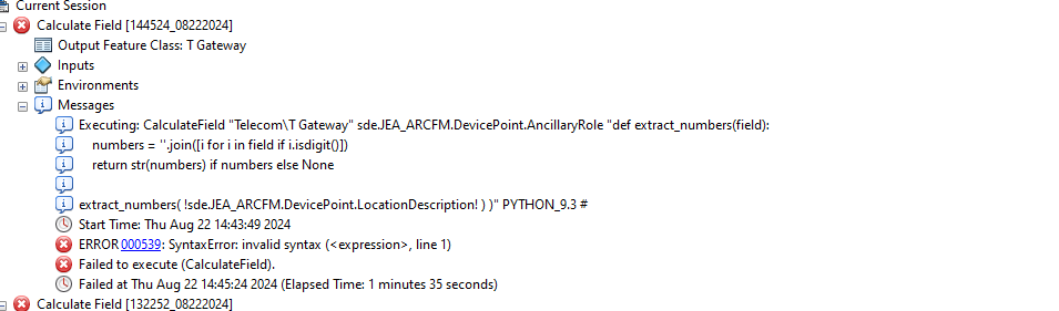

EGardner7
Hi Cody this script finished loading but it did not return anything. Do you happen to know what might have gone wrong? Really appreciate all of your help with this
CodyPatterson
Hey @EGardner7

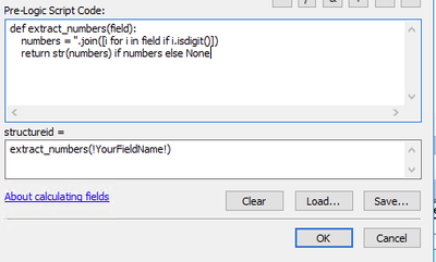

I was able to speak with someone nearby and get access to their ArcMap to check some things, are you entering the function like this here?
I believe the function will need to be in the pre-logic script code, and the extract_numbers in the assignment. Could you send a picture of this setup on your side?
