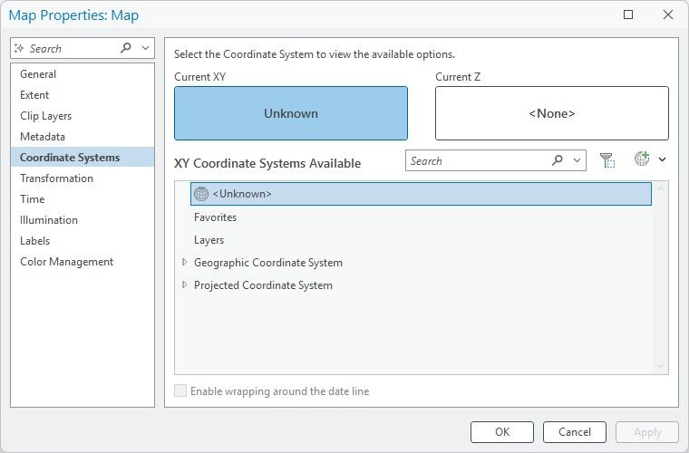

So I searched the ArcGIS Pro Idea community and found a great read for an Idea plus learned one can set an Unknown coordinate system for the Map View!  The link to the idea is How to clear\define the coordinate system of a par... - Esri Community - and to set the Map View to an Unknown Coordinate system, right-click on the Map view, select properties.  In the Map Properties, click the Coordinate System tab on the left and in the center of the UI, there is the word <Unknown>.  So one item addressed.  But the problem remains, ArcGIS Pro will not let you create a new feature and has the message "no editable layers" - grrrrrr...

It's the editability that is the issue. Just flat out won't let you do it. Turns out using a phony coordinate system works - Just have the map in that coordinate system and your feature class in that coordinate system. It's a hack, but it works. A straight 'cartesian' coordinate system (like graph paper, no distortion, x = 1,2,3,4, y = 1,2,3,4, etc...) would be awesome.
