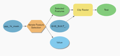

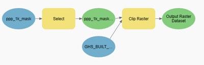

This works fine on a country by country level but becomes unsustainable when considering all the countries in the world, and then all those countries through time.  So then I tried to create a model in order to automate this task.  Initially I tried to replicate this task on a small scale using select and manually imputing the ISO code e.g. ISO = AFG
This seem to work well enough so I then attempted to scale up by iterating through all the features:
This model though ran in just a few seconds and didn't output anything.
Here are the logs:

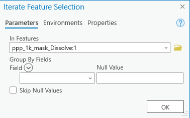

For your Iterate Feature Selection add a Group By field of 'ISO' this will then mean you 'Value' output from each iteration will be the string of each iterated row e.g. 'ABW' for the first iteration.  You will use this value as an inline variable for your output raster name.

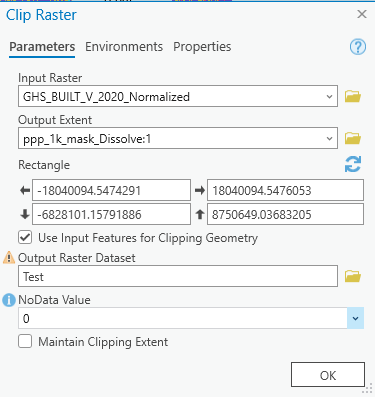

Clip Raster - what's the exclamation mark popup message?  What workspace are you saving to - folder or geodatabase?  If a folder it would need the filename to have an extension e.g. .tif
Output Raster Dataset - this is where you use the Value output name to name your file. Try:
%Value%_test.tif
if in a folder workspace or
%Value%_test
if in a gdb.  I'd also suggest saving as a tif in a folder rather than a gdb if so anyway.

The first model runs OK without the iterator?  If so then we can fortunately rule out a data issue.
Are you using inline variable substitution to name the output rasters?  Can you share a screenshot of the properties of:
Iterate feature selection
Selected features
Clip raster
in the second model.

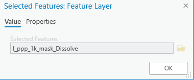

-Iterate feature selection
-Selected features
-Clip raster
%Value%_test.tif
%Value%_test

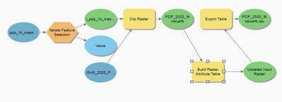

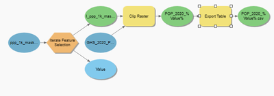

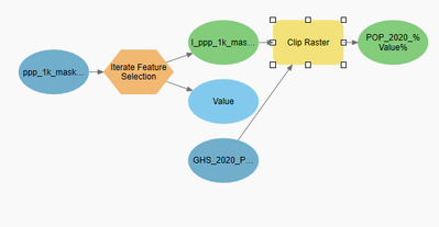

Hello! Thank you so much your solution worked brilliantly! I just have one last question, is it possible to automatically export attribute tables to csv?

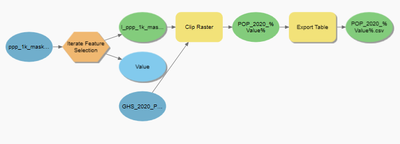

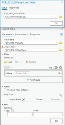

I've attempted to add the export table tool in the model builder but it only seems to output 1 file with missing data.
-model

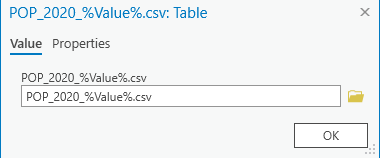

-export table
-output
- Actual output
-Excel output

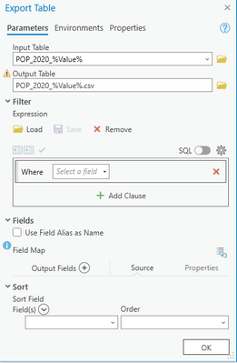

The error warning is just Warning 000258, showing that an output with that name already exists.

It looks ok, did you delete the CSV that's already in there?  Does it run once, produce then error?
Your filename in the screenshot doesn't match up with the other screenshots so I'm not quite understnading.

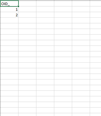

Hello! Just to clarify I was able to run the export rasters part of the model and was able to extract the needed information.
Meaning that this segment of the model was able to run perfectly without error!
The follow up question that I'm asking is why the export table tool does not seem to work as expected.

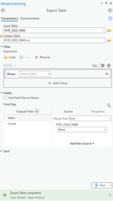

for instance when I examine the attribute table of VNM I would get the following information.
Which is verified when I would manually use the export table tool.
- Details
- Result
but when I would run it using the model builder the output is missing the 2nd and 3rd column
Here are the specifications of the export table tool:
Thank you so much for your time! you've been incredibly patient with me, my apologies if I am a little slow!

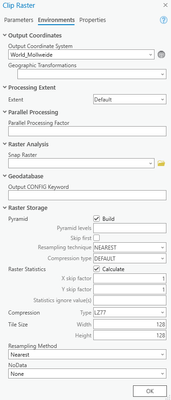

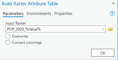

I'm guessing the clip raster tool in model builder isn't calculating statistics or somehow not producing a raster attribute table.  I would ensure RasterStatistics options are set in the environments settings of the clip raster tool in model builder https://pro.arcgis.com/en/pro-app/latest/tool-reference/environment-settings/raster-statistics.htm and maybe play around with adding the build raster attribute table tool as a process after the raster is generated and before export table https://pro.arcgis.com/en/pro-app/latest/tool-reference/data-management/build-raster-attribute-table...
Can you check in the attribute table of the iterated output rasters and see what columns are available?
I'd also recommend posting this new issue as a separate problem so it gets more traction for new views, and it helps to logically separate issues for posterity.

-The Raster Statistics box is checked
-I've played a bit with the build raster attribute table to the same result
-model
-build raster
-result
- Value from iterated raster table shows full data
Thank you so much for your time! and ill post this as a new question. You've helped me immensely!
