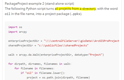

Now looking at the docs, I think I can tweak this code to look into individual project folders.These projects are BIG. The first one has been packaging all day!
