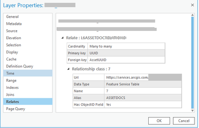

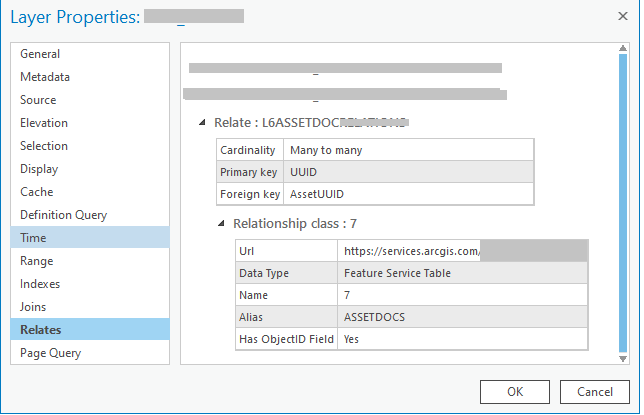

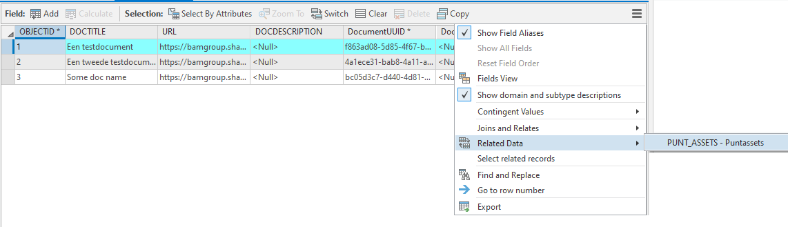

- I published the set to AGO where only one of the asset featureclasses has a relationship with the document table. I then added the remaining two relationships via the admin ArcGIS rest interface (add to definition). This does actually work and the service continues to function as expected. Additionally, in features such as pop-ups, WebAppBuilder apps, etc, the relations are properly visualized. However, whereas ArcGIS Pro does recognize newly added relationships, the document table relate properties shows 3 duplicated relations to the asset feature service layer originally created in ArcGIS Pro and not the other 2. Also, when navigating to the document attribute table and selecting to show related data, only the first relation is shown.
The relations shown for the missing asset feature layers in their respective properties are actually shown correctly:
