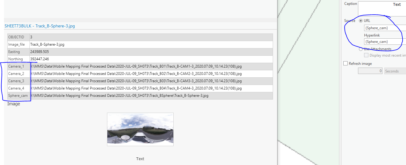

I am currently working with Mobile mapping software in Pro. My goal is to get the 5 images taken at each point to be shown in the pop up.
I have had success getting the pop up to show one image but can not get it to show more than one at a time 😞 does anyone know if this is possible?
I have tried putting the code {Camera_1,Camera_2,Camera_3,Camera_4,Sphere_Cam} into the URL and hyperlink field with no success.
Any help on this would be very much appreciated.
thanks

There's a Carousel item in the Configure Pop-ups pane that holds multiple images and charts. The pop-up will display one image at a time with scrolling arrows rather than displaying all of the photos at once, but at least you'll be able to scroll through the photos (with titles and captions for each).

That has worked well for me, thank you very much Linda! Have a good weekend
