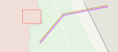

Hallo,
The area is a simple feature, the line is a network feature. However, if you try to move both features at the same time, only the geometry of the network feature is changed. Pro gives no indication of an error. Any idea?
Best regards
Dirk
