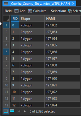

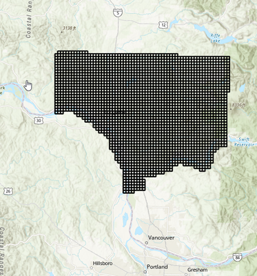

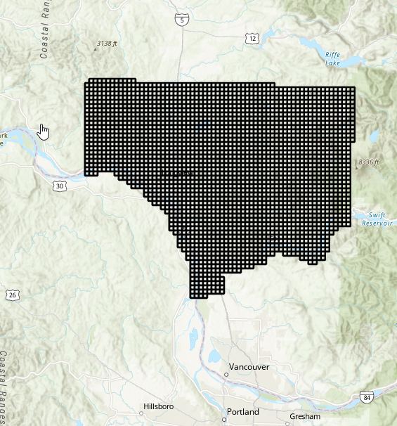

This is the grid index for the images:

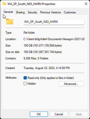

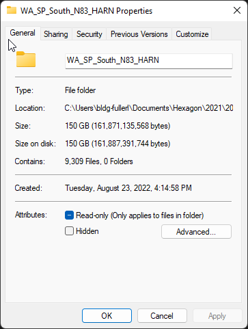

There are 2,326 images and the file size is 150 GB

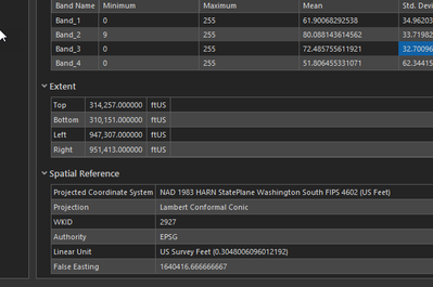

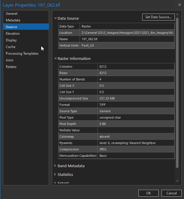

Here are the image properties for one of the images:

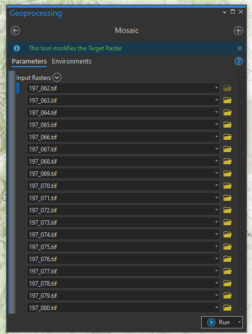

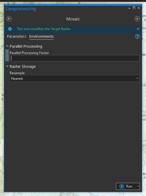

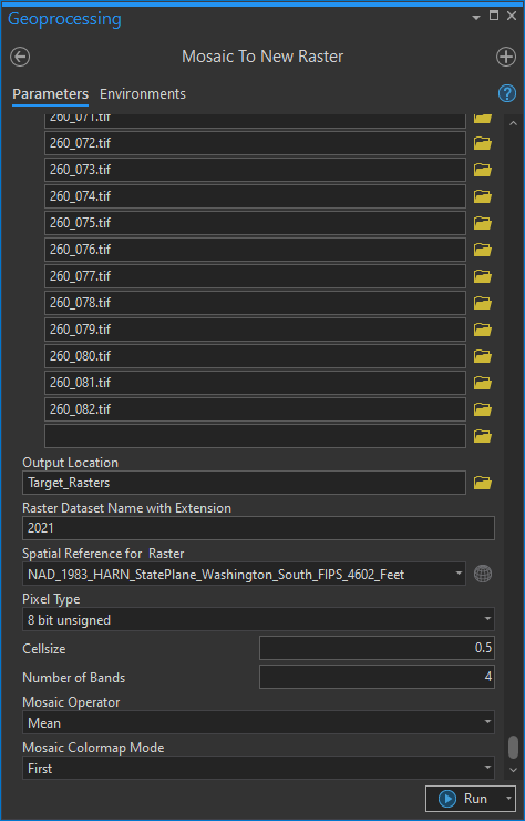

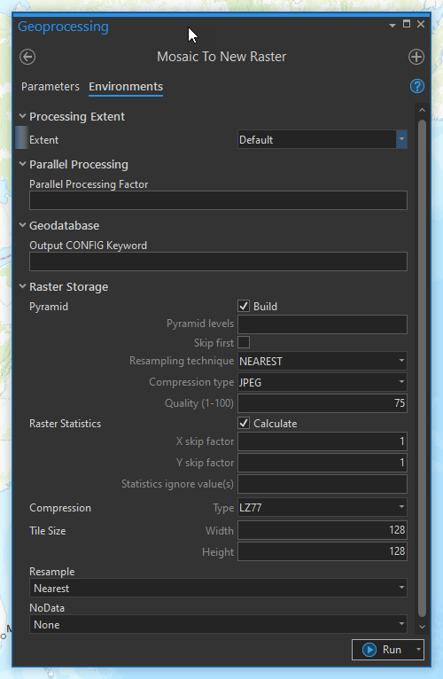

Here are the settings I used on Mosaic to New Raster:

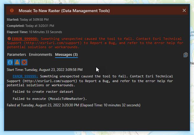

and the error message:

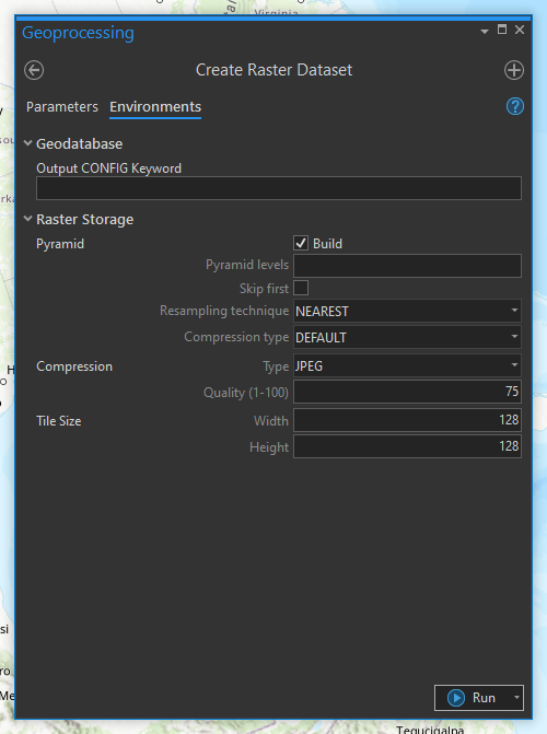

Create Raster Dataset settings( this worked):

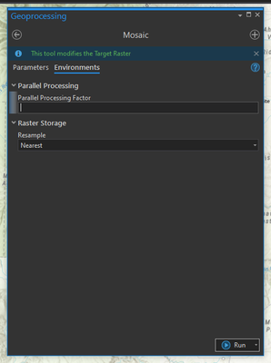

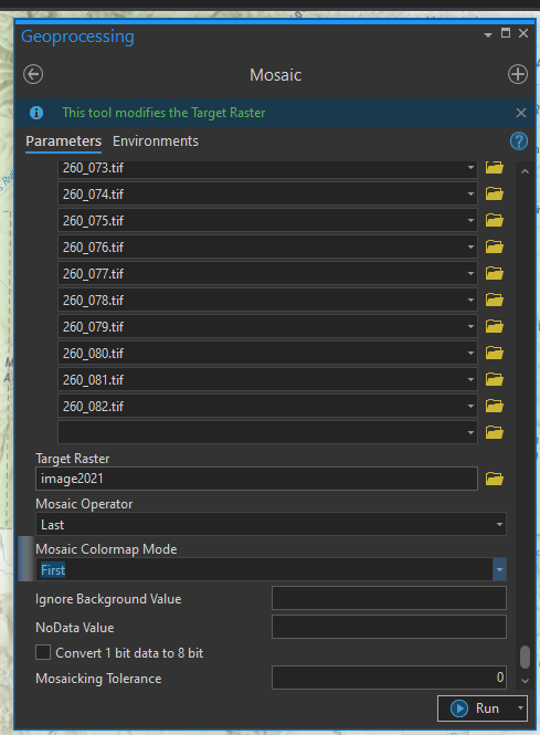

Mosaic settings (ArcPro ended up crashing after a couple of minutes):

First you need to create the mosaic dataset, then add rasters to it, then enhance/optimize it (if desired), then you have a mosaic to work with.
I normally use the  Create Mosaic Dataset tool to create a Mosaic dataset in a database (I just right click on database, new Mosaic Dataset).
Then in Catalog, right click on the new mosaic dataset and choose "Add Rasters".
Point that to the folder/workspace containing the tiff files and add the rasters to the Mosaic.  After the rasters are added, I normally calculate statistics and build overviews using the right-click on the mosaic dataset as well.
Then you use the newly created Mosaic dataset to create the tile package and you should be good to go.
The word doc you attached says the NAIP imagery supplied is in "UTM map projection, NAD83 (2011) datum, in meters" but the attached image properties say State Plane HARN.  I assume you used the project raster to convert them to HARN first?
Also, I see the imagery is 4 band, and normally, only the RGB bands are used, so I use the Composite Bands GP tool to reduce it to only 3 band so the final mosaic and tpk(x) is smaller.

I think that the metadata document had the original projection, then the imagery provider reprojected the data before they gave it out to the counties, because everyone in our area is using State Plan Harn for the most part. So I think the actual projection of what I am using is state plane.
