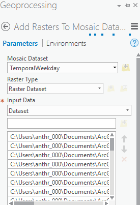

Just to add to this, I am using Pro 1.3 and ArcMap 10.4.1. 10.4.1 the workflow I am doing with mosaics works (though only when processing extent and raster mask environments are nulled), but in Pro the Add Rasters tool is stuck on a loop during the stage at which you are just selecting which datasets to pull in. The computer I am running handles decent scenes in CityEngine (2 G Nvidia, 16 GB ram, decent processor), so it is likely not the issue. OS is Microsoft 10. Just having similar performance issues. I will explore the steps to resolve below.

Thanks for letting us know about this.  We will investigate and get back to you.  Are all the rasters that you are using local or are some of them on a network.  I can only see half of your list in the screenshot.
DavidWasserman
Only local, though I got the tool to work if I added them a few at a time (which was painful). It starts at tool initialization, not even run time (the second the workspaces are defined). It's like one of the script initialization parameters consumes a lot of time or something. They are 32 bit kernel densities from different time periods.
