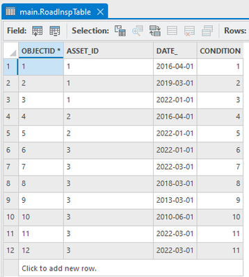

Using a standalone table like this:
Bud_0-1675719384325.png.
ASSET_ID    DATE_           CONDITION
1           2016-04-01      1
1           2019-03-01      2
1           2022-01-01      3
2           2016-04-01      4
2           2022-01-01      5
3           2022-01-01      6
3           2022-03-01      7
3           2018-03-01      8
3           2013-03-01      9
3           2010-06-01      10
3           2022-03-01      11
3           2022-03-01      11

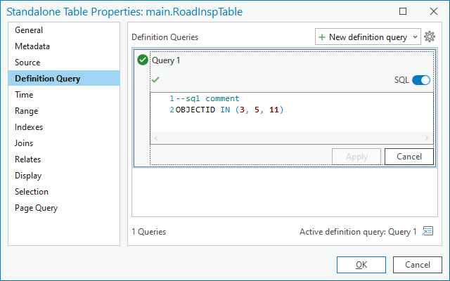

And using a non-expression builder definition query like this:
--sql comment
OBJECTID IN (3, 5, 11)

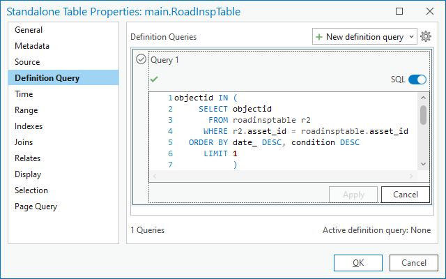

...or like this:
objectid IN (
     SELECT objectid
       FROM roadinsptable r2
      WHERE r2.asset_id = roadinsptable.asset_id
   ORDER BY date_ DESC, condition DESC
      LIMIT 1
Both of those definition queries work as-is and are active.
But after creating those definition queries, if I were to modify the SQL by doing something like add a few spaces to the end, or change a 1 to a 2, then the definition query would get disabled.
For example, if I were to change
--sql comment
to
--sql comment
OBJECTID IN (3, 5, 12)
then that would disable the definition query. That's not the expected result.
Here's a video example of adding spaces to the end of an SQL expression:
(view in My Videos)
Is that a known issue?

Esri Canada Case #03259723 - ArcGIS Pro: Modifying existing definition query disables the query
Esri inc confirmed that this issue is related to the previous bug [BUG-000155660] so we do not need to make a new one.
