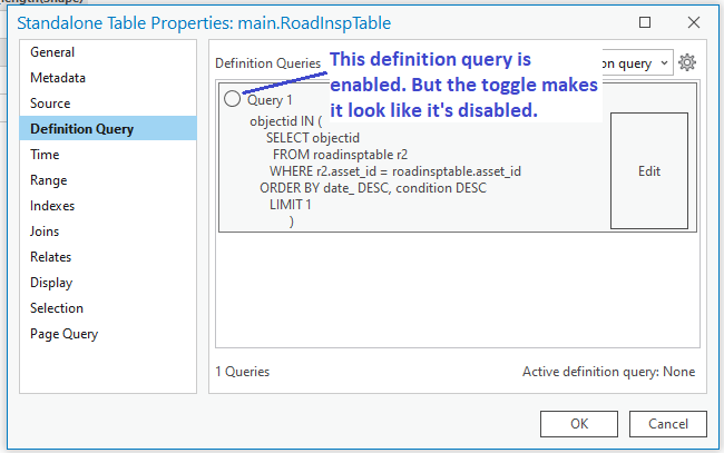

@KoryKramer Feel free to close this idea. Support is submitting bug reports for these issues.
Edited: I removed the part about hovering over the definition query.
Regarding the definition query window:
For an existing definition query that is enabled, the toggle makes it look like it's disabled.
GIF:
Could the UI be improved so that it's clear that an existing enabled definition query is displayed as being enabled?
Thanks.
ArcGIS Pro 3.0.3; mobile geodatabase.

I think you're missing something.
The query has 4 states:
  • active, normal
  • active, hover
  • inactive, normal
  • inactive, hover
The grey checkmark in the inactive hover state is meant to tell you "Hey, click here to activate this query!"
You have something different going on there: The query shows as inactive, although it apparently is active. Could be that this is due to your more complex query. Try a simple one.

Here's the data and SQL expression -- in case someone wants to reproduce that UI behavior:
Standalone table named roadinsptable:
ASSET_ID: Text
DATE_: Date
CONDITION: Long
ASSET_IDDATE_CONDITION
12016-04-011
12019-03-012
12022-01-013
22016-04-014
22022-01-015
32022-01-016
32022-03-017
32018-03-018
32013-03-019
32010-06-0110
32022-03-0111
32022-03-0111
SQL Expression:
roadinsptable.objectid IN (
     SELECT objectid
       FROM roadinsptable r2
      WHERE r2.asset_id = roadinsptable.asset_id
   ORDER BY date_ DESC, condition DESC
      LIMIT 1
Bud
Esri Canada Case number #03255222 “Definition query with subquery shown as inactive (incorrect)”
Bug number: BUG-000155660
Synopsis: Definition queries do not appear as active after enabling the query and reopening the definition query again.

From the video it's clear there is a bug with that type of complex SQL query. The bug being that when you open the DQ in Properties, it automatically disables itself.
I can't replicate it though. I had a similar SQL query (nested, but no joins) on a mobile geodatabase and it didn't bug out like this. I'm using Pro 3.0.3, btw.
