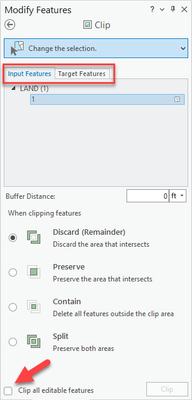

An alternative workflow would be to uncheck "Clip all editable features" at the bottom of the pane, then you get 2 tabs: input and target. In the input tab, select the island feature. In the target tab, select the water feature. Then click Clip.

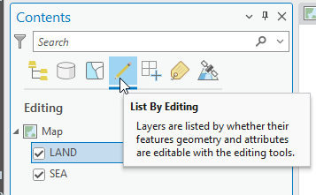

Either way should give you the same result - as long as the Water layer is editable of course, which you can check in List By Editing:

Hi Scott; The step of deleting the island polygon works after using the input and target selections. There is a hole in the gray shaded water and the island topo pokes through. So, the initial experiment was run on just one of the islands. When attempting the same on a second island, there is now a warning message when selecting the Ligurian Sea as the target that says "The current selection includes features or rows that are invalid for this operation. Click the selection tool to change the selection". However, there is no other desired selection - it has to be this one. And no idea what the message is referring to. But, I notice that while as a target, it is outlining the large polygon that defines the Sea, but now also outlines the first island which was the subject of the first clip exercise. Apparently that is the outline now for the hole. I select the input or the target polygon for each tab using the attribute table because the pull down selection tab in the clip pane does not allow simple individual picks with one click. Results using those line, polygon, lassos, circles etc, get very unpredictable results that can't just be easily exited from.
So, I experimented a bit further. I selected all the islands for the input clip, ran that on the target clip, deleted those islands and it works. Fortunately, those other island shapes are saved on another layer and are saved in an exported layer to avoid these through going changes - just in case.
I did this experimentation and reported the results here, because I have another much more complicated map to do the same with that has nearly a hundred islands to cut holes in the gray shaded water with. But apparently will have to select all of them en masse?  Progress at least.  Thanks;  Dave
