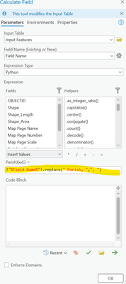

I have a simple calculation in a Calculate Field tool in modelbuilder. %Field Name% is a variable that references an actual field that is in the attribute table.

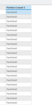

This is what the results look like:
I have been using inline variable substitution regularly and have never seen anything like this. If I double-click the field from the drop-down, instead of using '!%Field Name%!', it works as desired.
Does anyone know what is going on here and how to correct it?

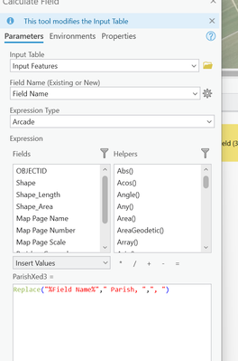

Would it be possible to test the function without the exclamation points? I remember having an issue where the exclamation points were causing an issue, but I'm unfortunately no longer able to test and can only give suggestions!
Cody
RandyMcGregor_BMcD

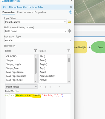

That populated the field with the name of the field. I tried Arcade and had the same effect. I have no memory of ever having to clarify that I want the contents of the field, rather than it's name to populate reccords. I'm either having an end-of-year brain freeze, or something strange is going on. 'ParishXed3' is the name of the field.
If I select the field from the drop-down, it works fine:

Oookay, so I went back to python and put the "!" marks outside of the quote marks and that works.  There's some trick to getting arcade to recognize that you are asking for the value within the field, rather than the field's name, but I don't know what it is.
