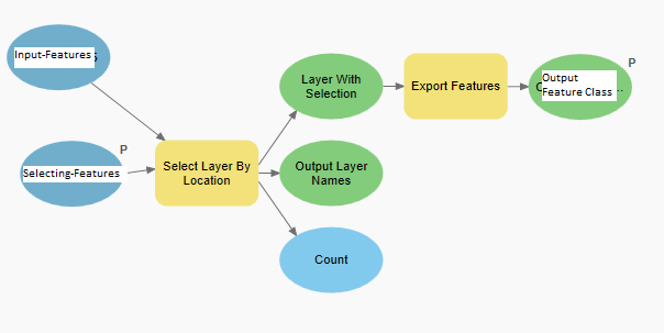

Hello all,
I'm currently working on trying to automate some work.
It involves only two tools:
  • 1. "Select Layer By Location"
  • 2. "Export Features"
The issue I'm running into is that the original symbology from the Input-Features is not being preserved in the Output Feature Class.
What's happening is - The Output Feature Class is adopting the symbology from the Selecting Features from the first tool (Select Layer By Location).
Everything else about the tool is running as it should, the only issue is the symbology.
Currently running ArcGIS Pro 3.1.3
*I also think it's important to note that I got the tool to run properly, correct symbology and all once, but never again.
Any help is appreciated!

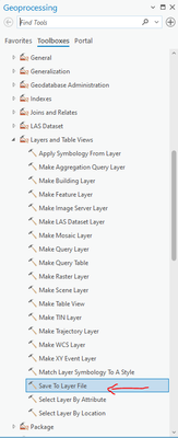

HusamJubeh
Hello
I have an answer that can solve the problem
Use the Save to Layer File tool, where the layer is exported in the same style
Try the tool before using it inside the model, and see the result
