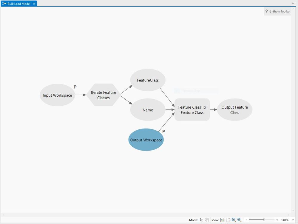

So I built an ArcGIS Pro 3.2 model in modelbuilder that I use in Instructor Led classes to copy all the data from a folder of shapefiles to an Enterprise Geodatabase (as referenced below) and each feature class in the eGDB has their own unique attribute values vs. the first one being used as the template.  I do not do any field mapping in the Fields parameter of the FC to FC GP tool in the model.

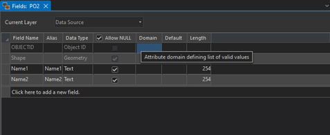

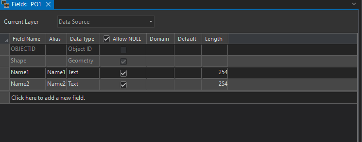

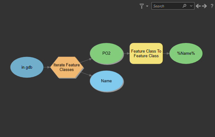

I tried to mimic your ModelBuilder and converted the data to a shapefile but I am getting the same result again. Here is  what I get when running the tool:
Input

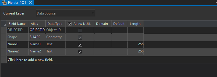

Output: (this one copied without any issue since this the first feature class in iteration)

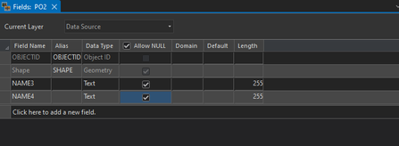

Input:
Output: (The schema of the feature class changed after copying it to match the first feature class)
The same happen to all feature classes/ Shapefiles.( It took the schema of the first feature class in the iteration)

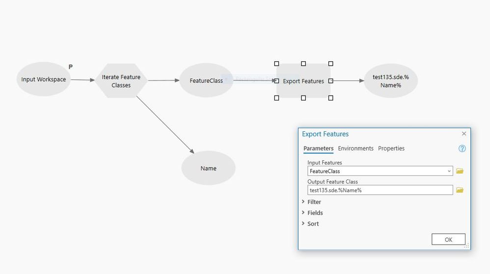

Interesting!  I guess I never noticed this before but YES my model is doing the same thing.  The first feature class is fine but all subsequent feature classes inherit the schema of the first.  That's got to be a bug.  So I started digging deeper and learned the Feature Class to Feature Class GP tool is deprecated (or soon will be) and that the Export Features GP tool is recommended.  So I created a new model as seen below with the following settings.  It worked!  Each feature class has it's "own" schema as it were.
Also, no need to convert to a shapefile as the input workspace can be a folder of shapefiles, a file geodatabase or an enterprise geodatabase.
