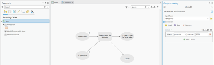

It's not entirely clear what you are asking for, always good to include images in your question rather than blocks of text...
That said is this what you want? I expose the two parameters and when I run it as a tool I get the default drop downs, as if I was running the tool by itself.
