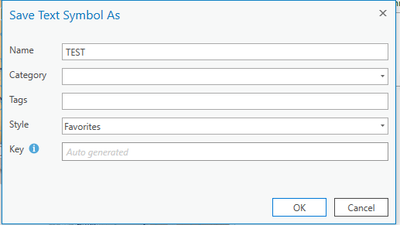

I have a bunch of map graphics in a map. I want to save the style I have given them in a style file so I can re-use this. But I can't seem to figure out how....
I have found a way to save the format of labels to a style by following the instructions here. See this page: called "Save a Text Symbol to a Style"....but the option to save to style does not seem to be available for graphics!
Is it possible to save the settings of a graphic text to Style....I'm pretty sure this was an option in ArcMap. Thanks all

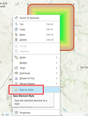

You can save the style of a graphic polygon, you need only right click on the graphic and choose save to style...
But! I can find no obvious way to apply this saved style back to a graphic, it's a style that you can apply to say a polygon in a Feature Class.  So 50% of the way there...

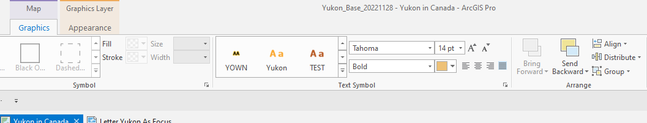

Ho! Thanks Duncan! I right-clicked on my graphic label, and chose "save to the style" in a style called 'favorite' and then was able to find it in the Graphic Ribbon

Excellent, I had not spotted it appears at the very end of that polygon symbol panel. I was looking for some sort of apply button. Anyway team work got us there, now 100% success! 🙂
