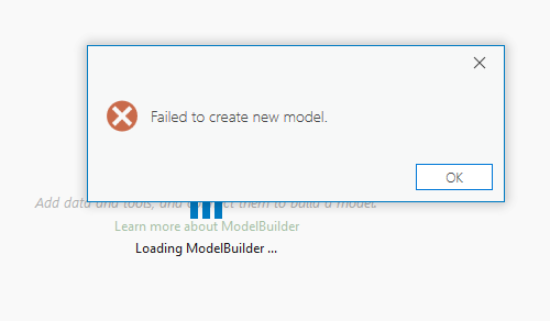

Hello,
I am trying to use ModelBuilder in Arc GIS Pro.  I have used it successfully in times past, however, it is now failing.  Whenever I click ModelBuilder on any project, I get the message found below "Failed to create new model". Any suggestions of what might be the issue?

Pro version?
BUG-000158118 for ArcGIS Pro (esri.com)
more details regarding your environment would be useful

Hi Dan,
Thank you for your help, my Pro Version is 3.1.2.
MattWilkie3
I get this with ArcGIS Pro 3.3 and project stored on a mapped network drive. I get the same error when trying to create a new toolbox (.atbx). I can however create new python toolbox (.pyt).
If work from a project on C: drive I can create all 3 - atbx, pyt, and model.
Adding a C: folder to the network project and creating inside that is not a workaround.
