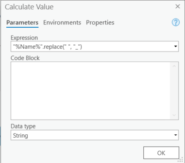

I'm missing something very basic here. I'm using Modelbuilder in ArcGIS Pro 2.9.5 and I'm using the Calculate Value tool to do a simple task of removing spaces from a name string, which I then want to pass on to a Make Table View tool as the name of the output file.
I'm entering an Expression in the Calculate Value tool and I'm leaving the Code Block blank. Name is a precondition. Output data type is String. I have made Value a Parameter. The output "Value" reads as expected in the code comments after the tool has run but when I try to use %Value% in the Make Table View Tool it always reads the output as a "1" so my output table is always named "1."

The problem is not the code doing the conversion -- it appears to be how to pass on the result as a Value.

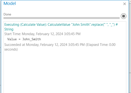

In the case of my code example shown above, I achieve the proper result, as you see here (below -- "John Smith" becomes "John_Smith"). But the Value in the green oval still reads as a 1.

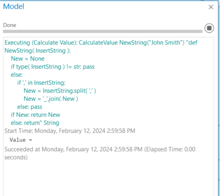

Unfortunately my attempt to use your code example did run for me but resulted in no Value and also a 1 in the green result oval! (see last image).
