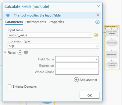

I use the Calculate Fields (multiple) geoprocessing tool in multiple model builder models. After updating to 3.1 each instance of the tool has had its 'Fields' parameters removed and the 'Expression Type' parameter reset to 'SQL' from 'Python 3'.
I can't be certain that the update has caused the issue, but they were all working fine pre-update. I've tried restoring my toolboxes to earlier versions but this has not resolved the issue.

I've opened the models up in 3.0.2 and they are configured as expected, it's only in 3.1.0 that the parameters have been removed and the expression type changed. Looks like some sort of compatability issue to me?

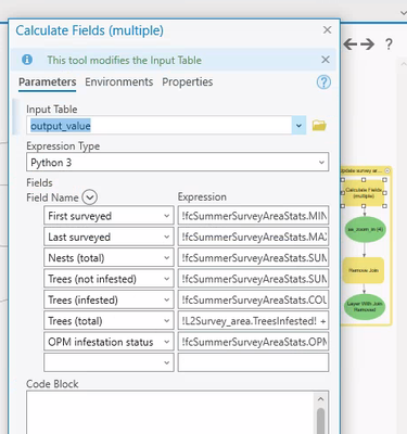

Tool in 3.0.2:
  Tool in 3.1.0
