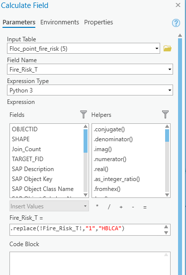

i am using arcgis pro 2.4. I am trying to change the values of an attribute suing model builder calculate fiend tool. however, I am getting an error when I run the tool. Below is a screen shot of what i am using and getting error 000539. Any thoughts or suggestions on how i can overcome this would be highly appreciated.

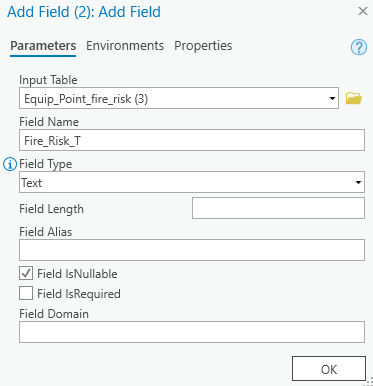

1 - From the geoprocessing pane drag the "Add Field" tool from the data management tools.

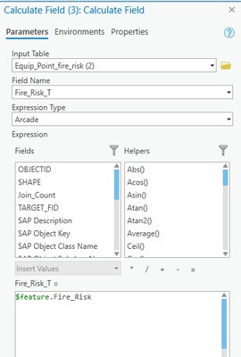

2 - Once the new filed is created, drag a "Calculate Field" tool from the data management tools. Use expression type Arcade and then insert the attribute you want to copy values from right at the bottom by double clicking it in the "fields" list.

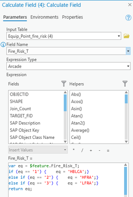

3 - Now that the values have been copied into the newly created attribute, drag another "Calculate Field" tool from the data management tools. This one will do the replacement of the values in the newly created attribute. By using the Arcade code expression right at the bottom. This uses the creation of a variable and a conditional "if" statement to find and replace values accordingly. PS - I had no null values in my data but if you do then you will need to adjust the statement to cater for nulls.

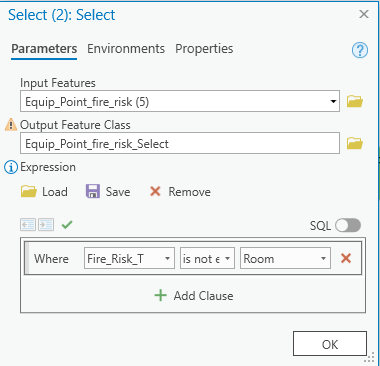

4 - Now that the data is comparable, drag a "Select" from the Analysis tools. Fill in the SQL expression and away you go...

what you did is wrong. you have to write the in a function in Code Block section, then call it .
try this:
Fire_Risk_T=
replace_func(!Fire_Risk_T!,"1","HBLCA")
=====Code Block====
def replace_func(field, old_text,new_text):
    return field.replace(old_text,new_text)

I assume !Fire_Risk_T! field has a Text datatype. If not, please create a new field with Text DataType and use Field Calculator on that field.
Check the following expression
!Fire_Risk_T!.replace("1","HBLCA")
