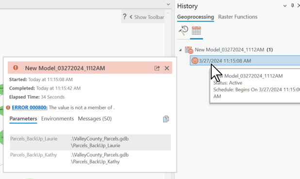

On one server, my schedule doesn't even run. There is no error message. It successfully schedules itself and saves and regardless of whether ArcGIS Pro is active and running or not, it just doesn't run. I have tried setting it to run once and I have tried setting it to run daily. It just doesn't run. What is the ongoing issue with this?
On my personal computer, I keep getting the below error. This runs perfectly when run manually.
New Model_03272024_1112AM
Parameters
Parcels_BackUp_Laurie .\ValleyCounty_Parcels.gdb\Parcels_BackUp_Laurie
Parcels_BackUp_Kathy .\ValleyCounty_Parcels.gdb\Parcels_BackUp_Kathy
Messages
Start Time: Wednesday, March 27, 2024 11:15:11 AM
Executing (Copy): Copy C:\Users\kcoll\OneDrive\Documents\ArcGIS\Projects\ValleyCounty_Parcels\ValleyCounty_Parcels.gdb\Parcels_Copy2_Dec23 C:\Users\kcoll\OneDrive\Documents\ArcGIS\Projects\ValleyCounty_Parcels\ValleyCounty_Parcels.gdb\ParcelsBackUp_Laurie FeatureClass #
Start Time: Wednesday, March 27, 2024 11:15:17 AM
Succeeded at Wednesday, March 27, 2024 11:15:23 AM (Elapsed Time: 5.43 seconds)
Executing (Created Features from Laurie): CreateFeatLaur C:\Users\kcoll\OneDrive\Documents\ArcGIS\Projects\ValleyCounty_Parcels\ValleyCounty_Parcels.gdb\Laurie_created_records
Start Time: Wednesday, March 27, 2024 11:15:23 AM
Succeeded at Wednesday, March 27, 2024 11:15:24 AM (Elapsed Time: 1.30 seconds)
Executing (Edited Features from Laurie): EditedFeatLaur C:\Users\kcoll\OneDrive\Documents\ArcGIS\Projects\ValleyCounty_Parcels\ValleyCounty_Parcels.gdb\Laurie_edited_records
Start Time: Wednesday, March 27, 2024 11:15:25 AM
Succeeded at Wednesday, March 27, 2024 11:15:26 AM (Elapsed Time: 1.40 seconds)
Executing (Merge): Merge C:\Users\kcoll\OneDrive\Documents\ArcGIS\Projects\ValleyCounty_Parcels\ValleyCounty_Parcels.gdb\Laurie_created_records;C:\Users\kcoll\OneDrive\Documents\ArcGIS\Projects\ValleyCounty_Parcels\ValleyCounty_Parcels.gdb\Laurie_edited_records C:\Users\kcoll\OneDrive\Documents\ArcGIS\Projects\ValleyCounty_Parcels\ValleyCounty_Parcels.gdb\Laurie_AllUpdates "PARCELNO "PARCELNO" true true false 30 Text 0 0,First,#,C:\Users\kcoll\OneDrive\Documents\ArcGIS\Projects\ValleyCounty_Parcels\ValleyCounty_Parcels.gdb\Laurie_created_records,PARCELNO,0,29,C:\Users\kcoll\OneDrive\Documents\ArcGIS\Projects\ValleyCounty_Parcels\ValleyCounty_Parcels.gdb\Laurie_edited_records,PARCELNO,0,29;LOT "LOT" true true false 5 Text 0 0,First,#,C:\Users\kcoll\OneDrive\Documents\ArcGIS\Projects\ValleyCounty_Parcels\ValleyCounty_Parcels.gdb\Laurie_created_records,LOT,0,4,C:\Users\kcoll\OneDrive\Documents\ArcGIS\Projects\ValleyCounty_Parcels\ValleyCounty_Parcels.gdb\Laurie_edited_records,LOT,0,4;BLOCK "BLOCK" true true false 5 Text 0 0,First,#,C:\Users\kcoll\OneDrive\Documents\ArcGIS\Projects\ValleyCounty_Parcels\ValleyCounty_Parcels.gdb\Laurie_created_records,BLOCK,0,4,C:\Users\kcoll\OneDrive\Documents\ArcGIS\Projects\ValleyCounty_Parcels\ValleyCounty_Parcels.gdb\Laurie_edited_records,BLOCK,0,4;PARENT_PAR "PARENT_PAR" true true false 254 Text 0 0,First,#,C:\Users\kcoll\OneDrive\Documents\ArcGIS\Projects\ValleyCounty_Parcels\ValleyCounty_Parcels.gdb\Laurie_created_records,PARENT_PAR,0,253,C:\Users\kcoll\OneDrive\Documents\ArcGIS\Projects\ValleyCounty_Parcels\ValleyCounty_Parcels.gdb\Laurie_edited_records,PARENT_PAR,0,253;Date "Date" true true false 8 Date 0 0,First,#,C:\Users\kcoll\OneDrive\Documents\ArcGIS\Projects\ValleyCounty_Parcels\ValleyCounty_Parcels.gdb\Laurie_created_records,Date,-1,-1,C:\Users\kcoll\OneDrive\Documents\ArcGIS\Projects\ValleyCounty_Parcels\ValleyCounty_Parcels.gdb\Laurie_edited_records,Date,-1,-1;Change_typ "Change_typ" true true false 50 Text 0 0,First,#,C:\Users\kcoll\OneDrive\Documents\ArcGIS\Projects\ValleyCounty_Parcels\ValleyCounty_Parcels.gdb\Laurie_created_records,Change_typ,0,49,C:\Users\kcoll\OneDrive\Documents\ArcGIS\Projects\ValleyCounty_Parcels\ValleyCounty_Parcels.gdb\Laurie_edited_records,Change_typ,0,49;LRSNum "LRSNum" true true false 8 Double 0 0,First,#,C:\Users\kcoll\OneDrive\Documents\ArcGIS\Projects\ValleyCounty_Parcels\ValleyCounty_Parcels.gdb\Laurie_created_records,LRSNum,-1,-1,C:\Users\kcoll\OneDrive\Documents\ArcGIS\Projects\ValleyCounty_Parcels\ValleyCounty_Parcels.gdb\Laurie_edited_records,LRSNum,-1,-1;PIN "PIN" true true false 255 Text 0 0,First,#,C:\Users\kcoll\OneDrive\Documents\ArcGIS\Projects\ValleyCounty_Parcels\ValleyCounty_Parcels.gdb\Laurie_created_records,PIN,0,254,C:\Users\kcoll\OneDrive\Documents\ArcGIS\Projects\ValleyCounty_Parcels\ValleyCounty_Parcels.gdb\Laurie_edited_records,PIN,0,254;GlobalID "GlobalID" false false true 38 GlobalID 0 0,First,#,C:\Users\kcoll\OneDrive\Documents\ArcGIS\Projects\ValleyCounty_Parcels\ValleyCounty_Parcels.gdb\Laurie_created_records,GlobalID,-1,-1,C:\Users\kcoll\OneDrive\Documents\ArcGIS\Projects\ValleyCounty_Parcels\ValleyCounty_Parcels.gdb\Laurie_edited_records,GlobalID,-1,-1;created_user "created_user" true true false 255 Text 0 0,First,#,C:\Users\kcoll\OneDrive\Documents\ArcGIS\Projects\ValleyCounty_Parcels\ValleyCounty_Parcels.gdb\Laurie_created_records,created_user,0,254,C:\Users\kcoll\OneDrive\Documents\ArcGIS\Projects\ValleyCounty_Parcels\ValleyCounty_Parcels.gdb\Laurie_edited_records,created_user,0,254;created_date "created_date" true true false 8 Date 0 0,First,#,C:\Users\kcoll\OneDrive\Documents\ArcGIS\Projects\ValleyCounty_Parcels\ValleyCounty_Parcels.gdb\Laurie_created_records,created_date,-1,-1,C:\Users\kcoll\OneDrive\Documents\ArcGIS\Projects\ValleyCounty_Parcels\ValleyCounty_Parcels.gdb\Laurie_edited_records,created_date,-1,-1;last_edited_user "last_edited_user" true true false 255 Text 0 0,First,#,C:\Users\kcoll\OneDrive\Documents\ArcGIS\Projects\ValleyCounty_Parcels\ValleyCounty_Parcels.gdb\Laurie_created_records,last_edited_user,0,254,C:\Users\kcoll\OneDrive\Documents\ArcGIS\Projects\ValleyCounty_Parcels\ValleyCounty_Parcels.gdb\Laurie_edited_records,last_edited_user,0,254;last_edited_date "last_edited_date" true true false 8 Date 0 0,First,#,C:\Users\kcoll\OneDrive\Documents\ArcGIS\Projects\ValleyCounty_Parcels\ValleyCounty_Parcels.gdb\Laurie_created_records,last_edited_date,-1,-1,C:\Users\kcoll\OneDrive\Documents\ArcGIS\Projects\ValleyCounty_Parcels\ValleyCounty_Parcels.gdb\Laurie_edited_records,last_edited_date,-1,-1;Shape_Length "Shape_Length" false true true 8 Double 0 0,First,#,C:\Users\kcoll\OneDrive\Documents\ArcGIS\Projects\ValleyCounty_Parcels\ValleyCounty_Parcels.gdb\Laurie_created_records,Shape_Length,-1,-1,C:\Users\kcoll\OneDrive\Documents\ArcGIS\Projects\ValleyCounty_Parcels\ValleyCounty_Parcels.gdb\Laurie_edited_records,Shape_Length,-1,-1;Shape_Area "Shape_Area" false true true 8 Double 0 0,First,#,C:\Users\kcoll\OneDrive\Documents\ArcGIS\Projects\ValleyCounty_Parcels\ValleyCounty_Parcels.gdb\Laurie_created_records,Shape_Area,-1,-1,C:\Users\kcoll\OneDrive\Documents\ArcGIS\Projects\ValleyCounty_Parcels\ValleyCounty_Parcels.gdb\Laurie_edited_records,Shape_Area,-1,-1" NO_SOURCE_INFO
Start Time: Wednesday, March 27, 2024 11:15:26 AM
WARNING 000117: Warning empty output generated.
Succeeded at Wednesday, March 27, 2024 11:15:27 AM (Elapsed Time: 0.88 seconds)
Executing (Copy (3)): Copy C:\Users\kcoll\OneDrive\Documents\ArcGIS\Projects\ValleyCounty_Parcels\ValleyCounty_Parcels.gdb\Parcels_CopyDec23 C:\Users\kcoll\OneDrive\Documents\ArcGIS\Projects\ValleyCounty_Parcels\ValleyCounty_Parcels.gdb\ParcelsBackUp_Kathy FeatureClass #
Start Time: Wednesday, March 27, 2024 11:15:27 AM
Succeeded at Wednesday, March 27, 2024 11:15:30 AM (Elapsed Time: 2.90 seconds)
Executing (Created Features from Kathy): CreateFeatKathy C:\Users\kcoll\OneDrive\Documents\ArcGIS\Projects\ValleyCounty_Parcels\ValleyCounty_Parcels.gdb\Kathy_created_records
Start Time: Wednesday, March 27, 2024 11:15:30 AM
Succeeded at Wednesday, March 27, 2024 11:15:32 AM (Elapsed Time: 1.28 seconds)
Executing (Edited Features from Kathy): EditedFeatKathy C:\Users\kcoll\OneDrive\Documents\ArcGIS\Projects\ValleyCounty_Parcels\ValleyCounty_Parcels.gdb\Kathy_edited_records
Start Time: Wednesday, March 27, 2024 11:15:32 AM
Succeeded at Wednesday, March 27, 2024 11:15:33 AM (Elapsed Time: 1.19 seconds)
Executing (Merge (2)): Merge C:\Users\kcoll\OneDrive\Documents\ArcGIS\Projects\ValleyCounty_Parcels\ValleyCounty_Parcels.gdb\Kathy_created_records;C:\Users\kcoll\OneDrive\Documents\ArcGIS\Projects\ValleyCounty_Parcels\ValleyCounty_Parcels.gdb\Kathy_edited_records C:\Users\kcoll\OneDrive\Documents\ArcGIS\Projects\ValleyCounty_Parcels\ValleyCounty_Parcels.gdb\Kathy_AllUpdates "PARCELNO "PARCELNO" true true false 30 Text 0 0,First,#,C:\Users\kcoll\OneDrive\Documents\ArcGIS\Projects\ValleyCounty_Parcels\ValleyCounty_Parcels.gdb\Kathy_created_records,PARCELNO,0,29,C:\Users\kcoll\OneDrive\Documents\ArcGIS\Projects\ValleyCounty_Parcels\ValleyCounty_Parcels.gdb\Kathy_edited_records,PARCELNO,0,29;LOT "LOT" true true false 5 Text 0 0,First,#,C:\Users\kcoll\OneDrive\Documents\ArcGIS\Projects\ValleyCounty_Parcels\ValleyCounty_Parcels.gdb\Kathy_created_records,LOT,0,4,C:\Users\kcoll\OneDrive\Documents\ArcGIS\Projects\ValleyCounty_Parcels\ValleyCounty_Parcels.gdb\Kathy_edited_records,LOT,0,4;BLOCK "BLOCK" true true false 5 Text 0 0,First,#,C:\Users\kcoll\OneDrive\Documents\ArcGIS\Projects\ValleyCounty_Parcels\ValleyCounty_Parcels.gdb\Kathy_created_records,BLOCK,0,4,C:\Users\kcoll\OneDrive\Documents\ArcGIS\Projects\ValleyCounty_Parcels\ValleyCounty_Parcels.gdb\Kathy_edited_records,BLOCK,0,4;PARENT_PAR "PARENT_PAR" true true false 254 Text 0 0,First,#,C:\Users\kcoll\OneDrive\Documents\ArcGIS\Projects\ValleyCounty_Parcels\ValleyCounty_Parcels.gdb\Kathy_created_records,PARENT_PAR,0,253,C:\Users\kcoll\OneDrive\Documents\ArcGIS\Projects\ValleyCounty_Parcels\ValleyCounty_Parcels.gdb\Kathy_edited_records,PARENT_PAR,0,253;Date "Date" true true false 8 Date 0 0,First,#,C:\Users\kcoll\OneDrive\Documents\ArcGIS\Projects\ValleyCounty_Parcels\ValleyCounty_Parcels.gdb\Kathy_created_records,Date,-1,-1,C:\Users\kcoll\OneDrive\Documents\ArcGIS\Projects\ValleyCounty_Parcels\ValleyCounty_Parcels.gdb\Kathy_edited_records,Date,-1,-1;Change_typ "Change_typ" true true false 50 Text 0 0,First,#,C:\Users\kcoll\OneDrive\Documents\ArcGIS\Projects\ValleyCounty_Parcels\ValleyCounty_Parcels.gdb\Kathy_created_records,Change_typ,0,49,C:\Users\kcoll\OneDrive\Documents\ArcGIS\Projects\ValleyCounty_Parcels\ValleyCounty_Parcels.gdb\Kathy_edited_records,Change_typ,0,49;LRSNum "LRSNum" true true false 8 Double 0 0,First,#,C:\Users\kcoll\OneDrive\Documents\ArcGIS\Projects\ValleyCounty_Parcels\ValleyCounty_Parcels.gdb\Kathy_created_records,LRSNum,-1,-1,C:\Users\kcoll\OneDrive\Documents\ArcGIS\Projects\ValleyCounty_Parcels\ValleyCounty_Parcels.gdb\Kathy_edited_records,LRSNum,-1,-1;PIN "PIN" true true false 255 Text 0 0,First,#,C:\Users\kcoll\OneDrive\Documents\ArcGIS\Projects\ValleyCounty_Parcels\ValleyCounty_Parcels.gdb\Kathy_created_records,PIN,0,254,C:\Users\kcoll\OneDrive\Documents\ArcGIS\Projects\ValleyCounty_Parcels\ValleyCounty_Parcels.gdb\Kathy_edited_records,PIN,0,254;GlobalID "GlobalID" false false true 38 GlobalID 0 0,First,#,C:\Users\kcoll\OneDrive\Documents\ArcGIS\Projects\ValleyCounty_Parcels\ValleyCounty_Parcels.gdb\Kathy_created_records,GlobalID,-1,-1,C:\Users\kcoll\OneDrive\Documents\ArcGIS\Projects\ValleyCounty_Parcels\ValleyCounty_Parcels.gdb\Kathy_edited_records,GlobalID,-1,-1;created_user "created_user" true true false 255 Text 0 0,First,#,C:\Users\kcoll\OneDrive\Documents\ArcGIS\Projects\ValleyCounty_Parcels\ValleyCounty_Parcels.gdb\Kathy_created_records,created_user,0,254,C:\Users\kcoll\OneDrive\Documents\ArcGIS\Projects\ValleyCounty_Parcels\ValleyCounty_Parcels.gdb\Kathy_edited_records,created_user,0,254;created_date "created_date" true true false 8 Date 0 0,First,#,C:\Users\kcoll\OneDrive\Documents\ArcGIS\Projects\ValleyCounty_Parcels\ValleyCounty_Parcels.gdb\Kathy_created_records,created_date,-1,-1,C:\Users\kcoll\OneDrive\Documents\ArcGIS\Projects\ValleyCounty_Parcels\ValleyCounty_Parcels.gdb\Kathy_edited_records,created_date,-1,-1;last_edited_user "last_edited_user" true true false 255 Text 0 0,First,#,C:\Users\kcoll\OneDrive\Documents\ArcGIS\Projects\ValleyCounty_Parcels\ValleyCounty_Parcels.gdb\Kathy_created_records,last_edited_user,0,254,C:\Users\kcoll\OneDrive\Documents\ArcGIS\Projects\ValleyCounty_Parcels\ValleyCounty_Parcels.gdb\Kathy_edited_records,last_edited_user,0,254;last_edited_date "last_edited_date" true true false 8 Date 0 0,First,#,C:\Users\kcoll\OneDrive\Documents\ArcGIS\Projects\ValleyCounty_Parcels\ValleyCounty_Parcels.gdb\Kathy_created_records,last_edited_date,-1,-1,C:\Users\kcoll\OneDrive\Documents\ArcGIS\Projects\ValleyCounty_Parcels\ValleyCounty_Parcels.gdb\Kathy_edited_records,last_edited_date,-1,-1;Shape_Length "Shape_Length" false true true 8 Double 0 0,First,#,C:\Users\kcoll\OneDrive\Documents\ArcGIS\Projects\ValleyCounty_Parcels\ValleyCounty_Parcels.gdb\Kathy_created_records,Shape_Length,-1,-1,C:\Users\kcoll\OneDrive\Documents\ArcGIS\Projects\ValleyCounty_Parcels\ValleyCounty_Parcels.gdb\Kathy_edited_records,Shape_Length,-1,-1;Shape_Area "Shape_Area" false true true 8 Double 0 0,First,#,C:\Users\kcoll\OneDrive\Documents\ArcGIS\Projects\ValleyCounty_Parcels\ValleyCounty_Parcels.gdb\Kathy_created_records,Shape_Area,-1,-1,C:\Users\kcoll\OneDrive\Documents\ArcGIS\Projects\ValleyCounty_Parcels\ValleyCounty_Parcels.gdb\Kathy_edited_records,Shape_Area,-1,-1" NO_SOURCE_INFO
Start Time: Wednesday, March 27, 2024 11:15:33 AM
Succeeded at Wednesday, March 27, 2024 11:15:34 AM (Elapsed Time: 0.83 seconds)
Executing (Merge all Update Records): Merge C:\Users\kcoll\OneDrive\Documents\ArcGIS\Projects\ValleyCounty_Parcels\ValleyCounty_Parcels.gdb\Laurie_AllUpdates;C:\Users\kcoll\OneDrive\Documents\ArcGIS\Projects\ValleyCounty_Parcels\ValleyCounty_Parcels.gdb\Kathy_AllUpdates C:\Users\kcoll\OneDrive\Documents\ArcGIS\Projects\ValleyCounty_Parcels\ValleyCounty_Parcels.gdb\Parcels_MergedUpdateRecords "PARCELNO "PARCELNO" true true false 30 Text 0 0,First,#,C:\Users\kcoll\OneDrive\Documents\ArcGIS\Projects\ValleyCounty_Parcels\ValleyCounty_Parcels.gdb\Laurie_AllUpdates,PARCELNO,0,29,C:\Users\kcoll\OneDrive\Documents\ArcGIS\Projects\ValleyCounty_Parcels\ValleyCounty_Parcels.gdb\Kathy_AllUpdates,PARCELNO,0,29;LOT "LOT" true true false 5 Text 0 0,First,#,C:\Users\kcoll\OneDrive\Documents\ArcGIS\Projects\ValleyCounty_Parcels\ValleyCounty_Parcels.gdb\Laurie_AllUpdates,LOT,0,4,C:\Users\kcoll\OneDrive\Documents\ArcGIS\Projects\ValleyCounty_Parcels\ValleyCounty_Parcels.gdb\Kathy_AllUpdates,LOT,0,4;BLOCK "BLOCK" true true false 5 Text 0 0,First,#,C:\Users\kcoll\OneDrive\Documents\ArcGIS\Projects\ValleyCounty_Parcels\ValleyCounty_Parcels.gdb\Laurie_AllUpdates,BLOCK,0,4,C:\Users\kcoll\OneDrive\Documents\ArcGIS\Projects\ValleyCounty_Parcels\ValleyCounty_Parcels.gdb\Kathy_AllUpdates,BLOCK,0,4;PARENT_PAR "PARENT_PAR" true true false 254 Text 0 0,First,#,C:\Users\kcoll\OneDrive\Documents\ArcGIS\Projects\ValleyCounty_Parcels\ValleyCounty_Parcels.gdb\Laurie_AllUpdates,PARENT_PAR,0,253,C:\Users\kcoll\OneDrive\Documents\ArcGIS\Projects\ValleyCounty_Parcels\ValleyCounty_Parcels.gdb\Kathy_AllUpdates,PARENT_PAR,0,253;Date "Date" true true false 8 Date 0 0,First,#,C:\Users\kcoll\OneDrive\Documents\ArcGIS\Projects\ValleyCounty_Parcels\ValleyCounty_Parcels.gdb\Laurie_AllUpdates,Date,-1,-1,C:\Users\kcoll\OneDrive\Documents\ArcGIS\Projects\ValleyCounty_Parcels\ValleyCounty_Parcels.gdb\Kathy_AllUpdates,Date,-1,-1;Change_typ "Change_typ" true true false 50 Text 0 0,First,#,C:\Users\kcoll\OneDrive\Documents\ArcGIS\Projects\ValleyCounty_Parcels\ValleyCounty_Parcels.gdb\Laurie_AllUpdates,Change_typ,0,49,C:\Users\kcoll\OneDrive\Documents\ArcGIS\Projects\ValleyCounty_Parcels\ValleyCounty_Parcels.gdb\Kathy_AllUpdates,Change_typ,0,49;LRSNum "LRSNum" true true false 8 Double 0 0,First,#,C:\Users\kcoll\OneDrive\Documents\ArcGIS\Projects\ValleyCounty_Parcels\ValleyCounty_Parcels.gdb\Laurie_AllUpdates,LRSNum,-1,-1,C:\Users\kcoll\OneDrive\Documents\ArcGIS\Projects\ValleyCounty_Parcels\ValleyCounty_Parcels.gdb\Kathy_AllUpdates,LRSNum,-1,-1;PIN "PIN" true true false 255 Text 0 0,First,#,C:\Users\kcoll\OneDrive\Documents\ArcGIS\Projects\ValleyCounty_Parcels\ValleyCounty_Parcels.gdb\Laurie_AllUpdates,PIN,0,254,C:\Users\kcoll\OneDrive\Documents\ArcGIS\Projects\ValleyCounty_Parcels\ValleyCounty_Parcels.gdb\Kathy_AllUpdates,PIN,0,254;GlobalID "GlobalID" false false true 38 GlobalID 0 0,First,#,C:\Users\kcoll\OneDrive\Documents\ArcGIS\Projects\ValleyCounty_Parcels\ValleyCounty_Parcels.gdb\Laurie_AllUpdates,GlobalID,-1,-1,C:\Users\kcoll\OneDrive\Documents\ArcGIS\Projects\ValleyCounty_Parcels\ValleyCounty_Parcels.gdb\Kathy_AllUpdates,GlobalID,-1,-1;created_user "created_user" true true false 255 Text 0 0,First,#,C:\Users\kcoll\OneDrive\Documents\ArcGIS\Projects\ValleyCounty_Parcels\ValleyCounty_Parcels.gdb\Laurie_AllUpdates,created_user,0,254,C:\Users\kcoll\OneDrive\Documents\ArcGIS\Projects\ValleyCounty_Parcels\ValleyCounty_Parcels.gdb\Kathy_AllUpdates,created_user,0,254;created_date "created_date" true true false 8 Date 0 0,First,#,C:\Users\kcoll\OneDrive\Documents\ArcGIS\Projects\ValleyCounty_Parcels\ValleyCounty_Parcels.gdb\Laurie_AllUpdates,created_date,-1,-1,C:\Users\kcoll\OneDrive\Documents\ArcGIS\Projects\ValleyCounty_Parcels\ValleyCounty_Parcels.gdb\Kathy_AllUpdates,created_date,-1,-1;last_edited_user "last_edited_user" true true false 255 Text 0 0,First,#,C:\Users\kcoll\OneDrive\Documents\ArcGIS\Projects\ValleyCounty_Parcels\ValleyCounty_Parcels.gdb\Laurie_AllUpdates,last_edited_user,0,254,C:\Users\kcoll\OneDrive\Documents\ArcGIS\Projects\ValleyCounty_Parcels\ValleyCounty_Parcels.gdb\Kathy_AllUpdates,last_edited_user,0,254;last_edited_date "last_edited_date" true true false 8 Date 0 0,First,#,C:\Users\kcoll\OneDrive\Documents\ArcGIS\Projects\ValleyCounty_Parcels\ValleyCounty_Parcels.gdb\Laurie_AllUpdates,last_edited_date,-1,-1,C:\Users\kcoll\OneDrive\Documents\ArcGIS\Projects\ValleyCounty_Parcels\ValleyCounty_Parcels.gdb\Kathy_AllUpdates,last_edited_date,-1,-1;Shape_Length "Shape_Length" false true true 8 Double 0 0,First,#,C:\Users\kcoll\OneDrive\Documents\ArcGIS\Projects\ValleyCounty_Parcels\ValleyCounty_Parcels.gdb\Laurie_AllUpdates,Shape_Length,-1,-1,C:\Users\kcoll\OneDrive\Documents\ArcGIS\Projects\ValleyCounty_Parcels\ValleyCounty_Parcels.gdb\Kathy_AllUpdates,Shape_Length,-1,-1;Shape_Area "Shape_Area" false true true 8 Double 0 0,First,#,C:\Users\kcoll\OneDrive\Documents\ArcGIS\Projects\ValleyCounty_Parcels\ValleyCounty_Parcels.gdb\Laurie_AllUpdates,Shape_Area,-1,-1,C:\Users\kcoll\OneDrive\Documents\ArcGIS\Projects\ValleyCounty_Parcels\ValleyCounty_Parcels.gdb\Kathy_AllUpdates,Shape_Area,-1,-1" NO_SOURCE_INFO
Start Time: Wednesday, March 27, 2024 11:15:34 AM
Succeeded at Wednesday, March 27, 2024 11:15:35 AM (Elapsed Time: 0.89 seconds)
Executing (Copy (2)): Copy C:\Users\kcoll\OneDrive\Documents\ArcGIS\Projects\ValleyCounty_Parcels\ValleyCounty_Parcels.gdb\Parcels_Original C:\Users\kcoll\OneDrive\Documents\ArcGIS\Projects\ValleyCounty_Parcels\ValleyCounty_Parcels.gdb\Parcels_Original_BackUp FeatureClass #
Start Time: Wednesday, March 27, 2024 11:15:35 AM
Succeeded at Wednesday, March 27, 2024 11:15:39 AM (Elapsed Time: 3.34 seconds)
Executing (Join Original and Update by Parcel Number): AddJoin Parcels_Original PARCELNO C:\Users\kcoll\OneDrive\Documents\ArcGIS\Projects\ValleyCounty_Parcels\ValleyCounty_Parcels.gdb\Parcels_MergedUpdateRecords PARCELNO KEEP_ALL NO_INDEX_JOIN_FIELDS NO_REBUILD_INDEX
Start Time: Wednesday, March 27, 2024 11:15:39 AM
Succeeded at Wednesday, March 27, 2024 11:15:39 AM (Elapsed Time: 0.26 seconds)
Executing (Select Non-Null Update-Date Records): SelectLayerByAttribute Parcels_Original "New selection" "Parcels_MergedUpdateRecords.PARCELNO IS NOT NULL" #
Succeeded at Wednesday, March 27, 2024 11:15:40 AM (Elapsed Time: 0.49 seconds)
Executing (Remove Join): RemoveJoin Parcels_Original Parcels_MergedUpdateRecords
Start Time: Wednesday, March 27, 2024 11:15:40 AM
ERROR 000622: Failed to execute (RemoveJoin). Parameters are not valid.
ERROR 000800: The value is not a member of .
Failed to execute (Remove Join).
Failed at Wednesday, March 27, 2024 11:15:40 AM (Elapsed Time: 0.05 seconds)
Failed to execute (NewModel).
Failed at Wednesday, March 27, 2024 11:15:42 AM (Elapsed Time: 31.57 seconds)
