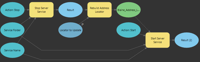

Interesting thread. I'm interested in the opposite: if the tool fails, I want the model to keep going instead of terminating. My use case is that I have a python script as a tool that stops a locator service, runs the rebuild address locator tool, and then regardless of success or failure of the update, it needs to turn that service back on instead of terminating the model completely. The important thing to note here is that it would likely continue if I didn't have the precondition set, but the precondition is required to enforce it to run in a specific order.
ModelBuilder modelModelBuilder model
