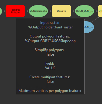

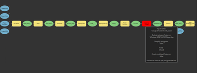

Might be hard to see but it takes the input parameters of the workspaces, "Output Folder" and "Output GDB" and then right before Raster to Polygon Tool I have it converting it to an integer raster to create an integer raster for the format.
The Output Folder Path is:
U:\ProjectData\State\ProjectName\ProjectFiles\USGS
The Output GDB path is:
U:\ProjectData\State\ProjectName\Databases\Site_Project_SDE.gdb

If I run it in standalone, I do not receive the error and the geoprocessing tool works. Seems to only be an issue with the way the model is running it.

your shapefile should be going to a folder as well.  it appears to be going to a gdb, drop the *.shp if you want it to go to the output gdb or alter the path to the output folder

@DanPatterson - thank you, that was it! I dropped the ".shp" because it's going to the file GDB
