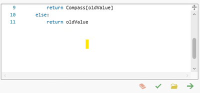

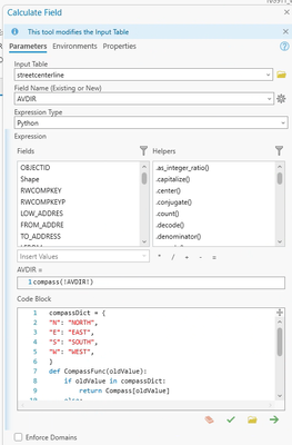

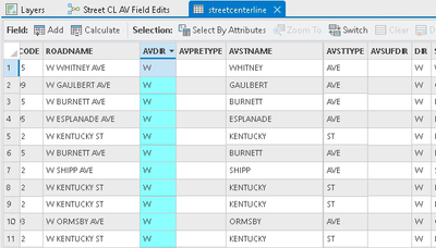

So below is a partial screenshot of my table with the field AVDIR highlighted.  I decided to start on this field since it has fewer values (only 4 - N, S, E, W) which I need fully spelled out (NORTH, SOUTH ETC).  Below that is what I currently have in the Code Block which is all wrong; I know.  Your explanation/analogy is great, I'm just not sure how to apply it.
AlfredBaldenweck
MVP Frequent Contributor
Goes back to the earlier issue of calling the dictionary and the function the same thing.
You want to return compassDict[oldValue]
