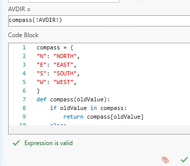

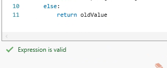

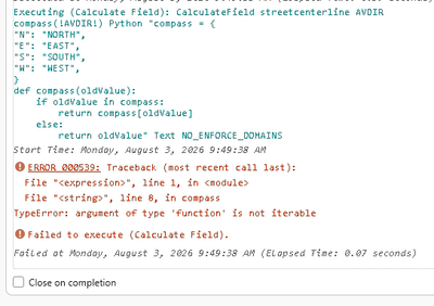

Thank you for your thoughtful responses!  So I decided to try your recommendation on another field first (one with fewer and simpler values) since I know nothing about coding!  I'm using a street pre-directional field called "AVDIR".  The only four values are N, S, E, W which I need fully spelled out.  Below is what used; however when I run it fails (see third screenshot below).

Two things:
  1. You named a variable (your direction dictionary) the same as a function. That's confusing for humans and even more confusing for the computer, which is why you're getting the error.
  2. Your dictionary should be inside your function if you want to be able to access it.
def compass(field):
    dirDict = {"N":"North"}
    #code
    #code
    x = dirDict[field]
    return
Try changing the name and the location of the dictionary and see if that fixes it.
MErikReedAugusta
MVP Regular Contributor
TL;DR: Line 1 and Line 7 should have different names, and Line 8 should be looking at the name from Line 1.
The issue is that you used the same name for both the function and the dictionary, and line 1 is looking at the wrong one. This one is partly on me. Python is case-sensitive, and since I tend to use Title Case for Functions and lower case for variables, I didn't notice that I'd called both a variation of "Suffix" in my examples, which could potentially be confusing.
Since Python is case-sensitive, you could just capitalize one of them like this, and it would work (note the lowercase on line 1 and line 4, compared to the uppercase on line 3):
compass = {'N': 'NORTH', ...}
def Compass(oldValue):
  if oldValue in compass
But it's probably better to get in the habit of being more explicitly different, for safety & clarity:
compassDict = {'N': 'North', ...}
def CompassFunc(oldValue):
  if oldValue in compassDict:
