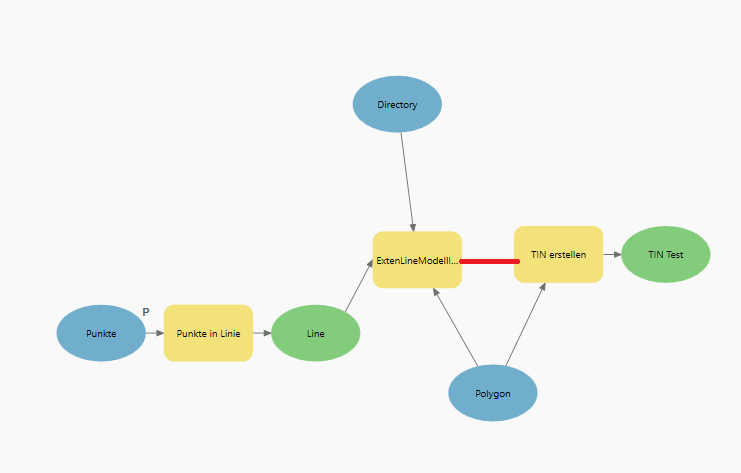

I now have a script that extends a Line to the edge of a Polygon (see my previous post), and I would like to use this extended Line as input for another Toolbar — specifically, in "Create a TIN" as a "Soft Line." Does anyone know how I can do this?
Hier what I'm missing: since I can't connect two Processes, I don't know how I can proceed.
Hier there is my Script:

BobBooth1
You need to define the outputfc result layer as an output parameter of your tool.
https://pro.arcgis.com/en/pro-app/latest/help/sharing/overview/inputs-and-outputs.htm
Once that is done, when you add the tool to ModelBuilder, the tool will show an output oval that you can connect as input to other processes.
https://learn.arcgis.com/en/projects/create-a-python-script-tool/#make-a-tool-and-add-parameters:~:t....
https://support.esri.com/en-us/knowledge-base/how-to-add-output-parameter-in-a-model-builder-for-a-s...
