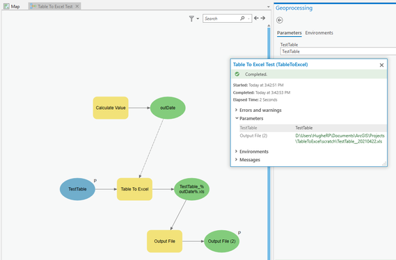

In ArcPro 2.7.1 I have replicated an issue that is driving me crazy.  What I need is to be able to use the output string from the Calculate Value tool as an inline variable in the output name of the Excel file.

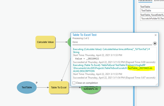

When I run this in model builder it outputs the correct name.

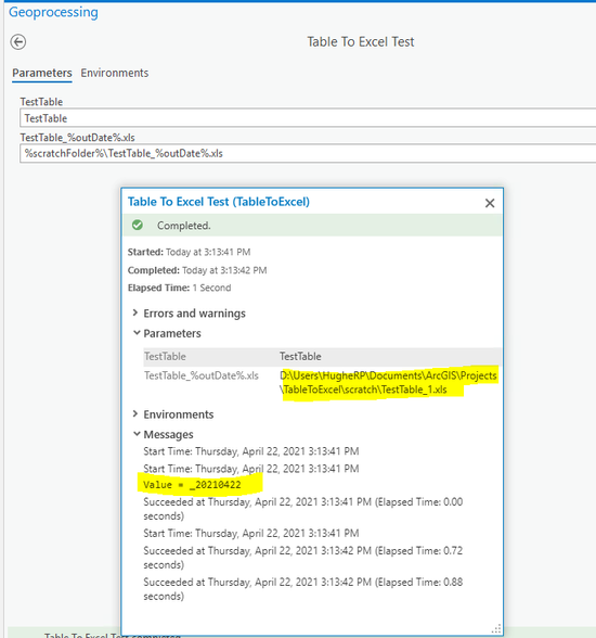

When I run as a tool in the toolbox, the value "1" is always used as the result of Calculate Value.
Result from Model Builder window:
Result from Toolbox Model (prior to publishing):
What am I missing?  Is this expected behavior or a bug?

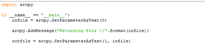

To resolve this issue, I've added a script tool that has in input parameter of type 'Data Element' and an output parameter of type 'File'.  When adding this script tool to the model and using it's output as the model output, the Model's output parameter changes to Derived.  That seems to fix it for desktop.  Next to test the Web Tool.
