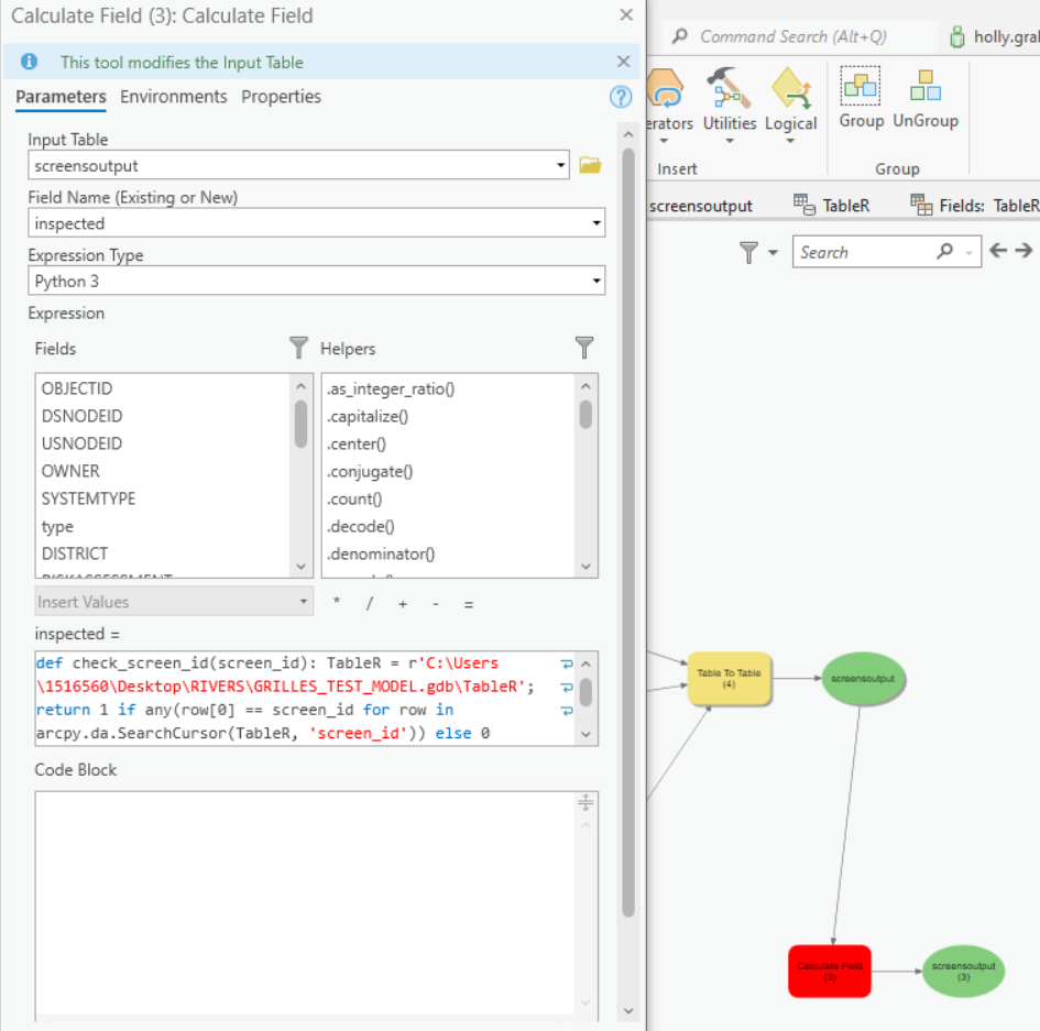

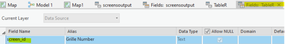

Im running the calculate field tool with screensoutput as my input table, selecting the field "inspected" that I want to populate, and the code I'm using is asking to put a 1 where there is a match, and 0 where there is no match when compared to the TableR (list of inspections). The key field in both is screen_id (which is the asset ID)

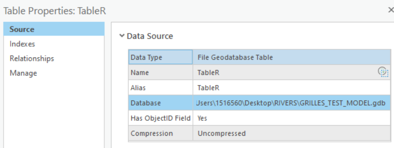

I keep getting a syntax error. And i think it doesnt like my table name, but I'm sure I've got it right, the table is an output of my model in a previous step, so unless thats becoming an issue?

The expression field expects a simple Python expression. Put your function into the Code Block field.
# Inspected =
check_screen_id(!SCREEN_ID!)  # change to your screen id field name, keep the exclamation marks
# Code Block
def check_screen_id(screen_id):
    TableR = "..."
    with arcpy.da.SearchCursor(TableR, ["screen_id"]) as cursor:
        for row in cursor:
            if row[0] == screen_id:
                return 1
    return 0

HollyGraham
Johannes - thankyou so much!!
