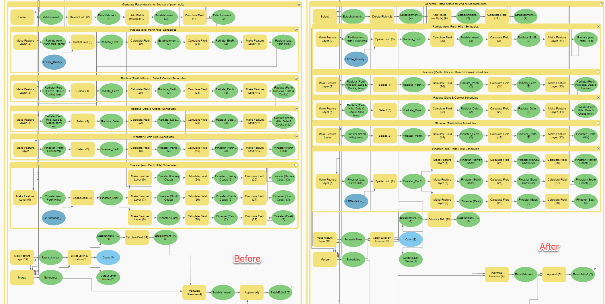

Hi All. Has anyone else noticed that after upgrading to 3.5 (could be 3.4, but we skipped that version), that the Auto Layout function produces a less well displayed result? You can see in my screenshot below an existing model that was created with a previous version. If I open in 3.5 and click Auto Layout, it condenses all the groups, resulting in overlapping boxes which are harder to discern. And it's not just the grouping boxes that overlap, but they in turn also impinge on tools, resulting in no white-space around them (top row of tools for example).
I can't figure out how to change this if it's a settings thing. But even if I can, it's still kind of annoying that it's happened.

@LindsayRaabe_FPCWA  - I've reviewed the internals and I have not seen any Esri Support cases logged showing this issue.  I would strongly suggest you contact Esri Support Services to create a case so it's logged and available to the ArcGIS Pro Dev Team.  This is definitely not expected behavior.

Confirmed bug - BUG-000180065

Hopefully addressed by the updated UI in ArcGIS Pro 3.6!

For BUG-000180065, it shows in the Product Plan but not fixed at ArcGIS Pro 3.6.  But, maybe, the new MB UI fixes the issue with the new design.

@LindsayRaabe_FPCWA - I'm seeing that BUG-000180065 is fixed at ArcGIS Pro 3.7, so the next major release in 2026.

ugh, this is terrible. We just upgraded from 3.3. to 3.5.5. We aren't going to 3.6 until probably next year. Thanks for the post. Do you have the link for the BUG-000180065? - google search and I can't find the info.
I should add - I didn't click the "Auto Layout" and Pro 3.5.5 moved all of my model parts around. I had them how I wanted them...Or I might have - I didn't realize there was an icon for Auto Layout on the bottom right next to "Fit to Window". I might have clicked on that by mistake when clicking the Fit to Window. sad.
