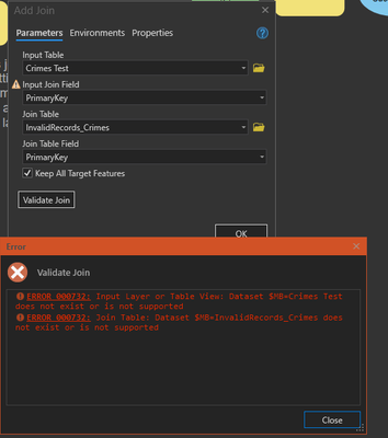

I am in model builder trying to add a join to a layer stored in my SDE, but rather than add the join to the actual layer in SDE, it is adding the join to a temporary layer. This is causing a problem for me because I am using a join to remove orphaned records from the layer in SDE.
I am not sure if this would have anything to do with it, but when validate the join in the "Add Join" tool, I get these errors:
When I run the model, it does not error out. Thank you in advance for your help!

joins are temporary in add join Add Join (Data Management)—ArcGIS Pro | Documentation
with join field they aren't Join Field (Data Management)—ArcGIS Pro | Documentation
maybe it is the temporary layer with the temporary join that is the issue
