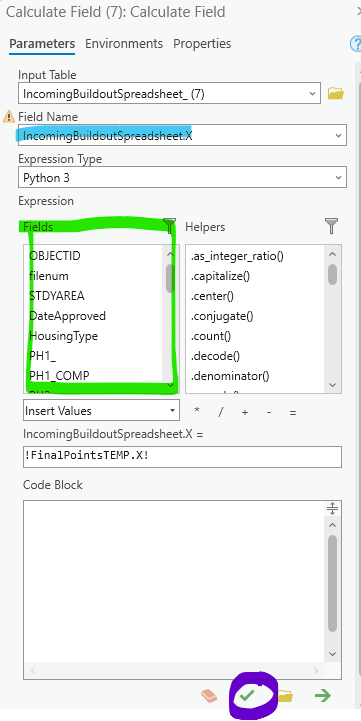

I've been using model builder for over 2 decades now -- back to the days of ArcMap 8.x.  A very common workflow is to join a 'standalone table' to a feature class and then use the Calculate Field tool to either transfer values from the table or perform actual numeric calculations across both tables. I've done that probably 100s of times over the years and it used to be easy in model builder. When you'd open up the Calculate Field tool, the list of fields where you could specified the target field would be listed as FeatureClass.Field or Table.Field. This appears to still happen most of the time, maybe all of the time (see blue highlight below). Then you could double click fields in the area circled in green to start building your calculation expression.
But now the fields from the joined table aren't even listed in the green list any more. But I remembered that with Python, the expression would be !tablename.fieldname!. When I type that by hand and click the verify button (green check mark circled in purple above) it doesn't report any errors or problems. But when I run the tool, it fails.
OK, so let's try Arcade instead. Since the fields from the joined tables are listed in the fields list, we have to guess the correct syntax. Based on how it used to work with VB expressions and python expressions, I've tried:

fixed in 3.1
BUG-000153592 for ArcGIS Pro
