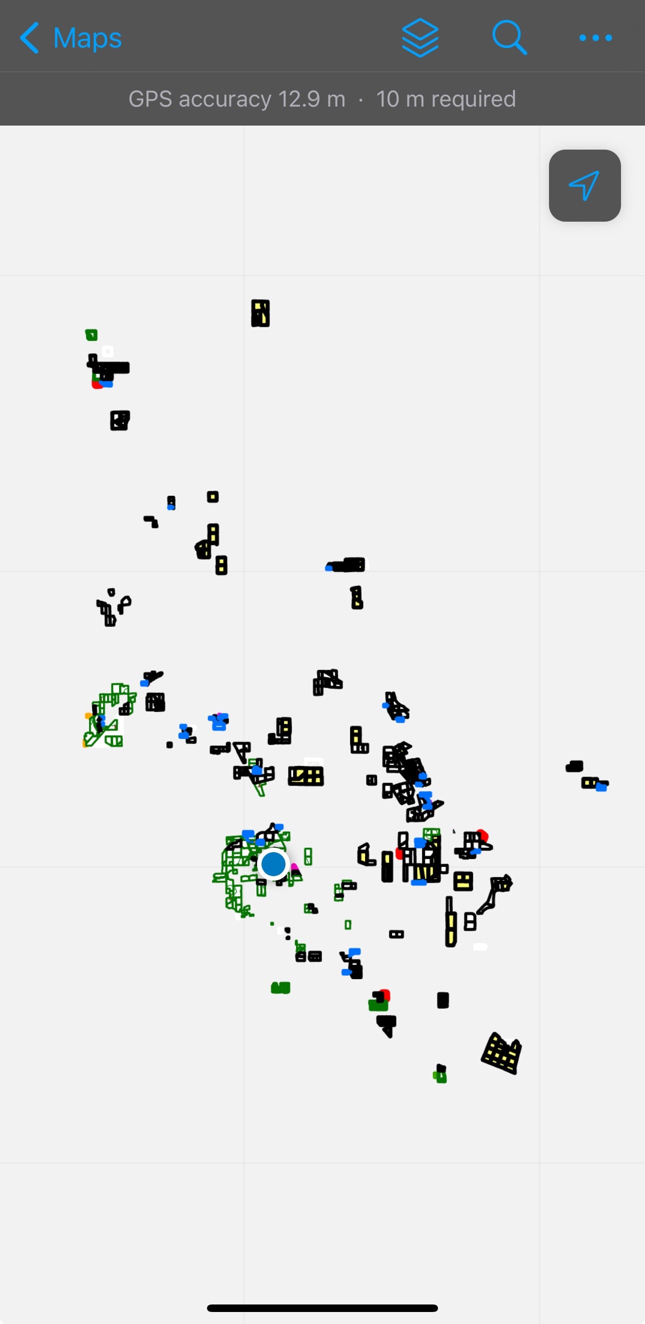

Newbie here, I have uploaded a mobile field map package and accessed it on my ArcGIS field maps app on my iPhone, but it is just showing the polygons I created on a blank white background. The hybrid basemap is missing and I am not sure why it did not export with the map originally. Any help is greatly appreciated. Thank you.

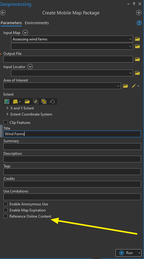

Unfortunately, you need a Publisher license to do so. See below screengrab that shows you where this option would be with the extension enabled.
If this is one of the standard Esri basemaps that is being referenced, then you can easily download it as a tpkx file, then add this to the map and so remove the dependency on any online layers.  Without the Publisher extension, all the data you include in the MMPK must be downloaded/packaged for offline use.
