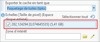

Problem : We want to create a TPKX with the existing cache. When we use the Export Tile Cache geoprocessing tool, we cannot see any other level other than the last one created (L21).
After investigation, we found out that that the problem is with the conf.properties file of the cache.
The conf.properties file is rewritten every time we cache a new level. Because we generate L21 lastly, both the <Key>MinScale</Key> and <Key>MaxScale</Key> will be at value 282.12429400000002. It is a problem because the Export Tile Cache geoprocessing tool is reading that file to verify what are the available levels.
Solution : As a workaround, manually edit the <Key>MinScale</Key> of the conf.properties file to reintroduce all the existing levels in the Export Tile Cache geoprocessing tool window.
