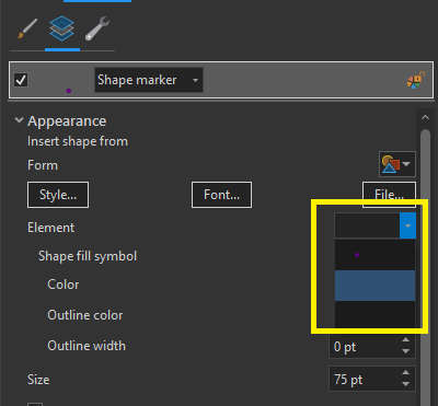

I have created an .svg in Inkscape to use as a point symbol in Pro (see below for screenshot). When I add the .svg in symbology it just shows the purple circle. When I click the down arrow beside element in the symbology window there are three spaces but the letter doesn't appear. See the last screenshot for the symbology window.
Does anyone know how to solve how to get the white P? When I click on the .svg file in windows explorer it appears as it should.

I have had the same only with some of my inkscape .svg graphics.
I tried saving it as an "optimized .svg". You can choose this option while saving something in inkscape.
After this all the Elements in my .svg showed up in ArcGIS Pro.
Hope that helps!
