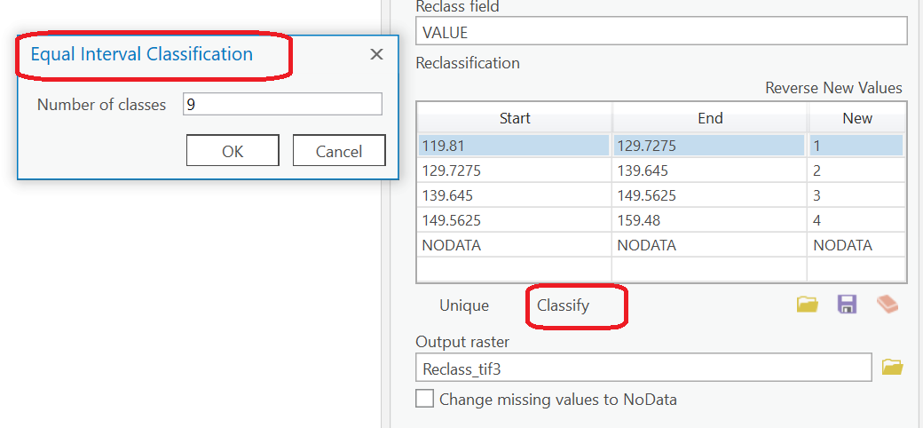

In ArcMap, the Reclassify (Spatial Analyst) tool has a Classify menu that offers many predefined classification schemes such as quantile, jenks, etc... In ArcGIS Pro (2.4.1) , the Classify button limits the classification scheme to "equal interval". Are the classification options removed from Reclass, or am I missing a setting?

I was working off of a stretched classification scheme in my legend. Per your suggestion, I switched the symbology to classified using a Jenks classification method however, the reclassify tool still limits the method to equal interval.

This idea is open over on ArcGIS Ideas‌ https://community.esri.com/ideas/14816
You should vote for that.

However, the last suggestion from the Dev team quoted on the Ideas page ("Add image to tool and it will take the values from the renderer") does not seem to be working in my case (version 2.4.2). For example, I've classified a raster (double precision pixels) using Jenks method in the Contents pane, yet the breaks do not carry over to the reclassify tool which still defaults to the equal interval classification (see my last screen grab).
