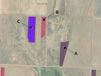

To make it a bit easier on myself I made a new map and layered the Troubling Polygon Layer atop a Map Image Layer derived from the same service, with the former displayed with Difference Layer Blend and Hard Light Feature Blend.  Resulted in stacked polygons showing up as a nice bright blue, and single polygons looking like a grey/purple block.  Red is a different situation.
