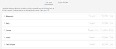

Also a screenshot of the Organization > Licenses > User Types page will give me an idea of the available user-types (like the one I shared).

See screenshot.
JayantaPoddar
MVP Alum
You have already maxed out Creator user-type licenses. Do you have any available Field Worker user-type?
If not, then you might need to connect with your local Esri distributor to get additional user-types. The alternative would be to delete 02 existing Creators, which is not suggested.
