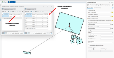

will allow you to get the centroid of multipart polygons, and it will probably not be within the extent of an existing polygon part.  The nice thing is that everything done has an ID value, so what I am thinking is
Generate Origin-Destination Links (Analysis)—ArcGIS Pro | Documentation
with the centroid of the multipart polygon as the "origin" and the singlepart representation of the destinations.  The distance LINK_DIS field could be queried by some threshold distance to identify outliers
A spatial join isn't recommended since you could inadvertantly "assign" one of the singleparts to another multipart polygon because of the distance.

This is brilliant and does exactly what I needed 😀.
