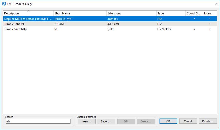

This ESRI technical document says with the Data Interoperability extension you can read mbtiles. I would like to use the tiles as a basemap in Pro, and then export the tiles to a .tpk file. Is this possible? In the Workbench I can find the mbtiles reader, but I don't know where to go from there.

Thanks for helping me along. But I am still stuck. The Quick Import Tool has a reader format for vector MBTiles; when I run it I get the error message that the reader is for vector tiles only and that I should use the MBTiles reader (which is not in the list). When I open the Data Interoperability workbench I do see a reader for raster MBTiles but I can't figure out how to proceed using the Workbench (ie I can add the Reader, but what Transformer or Writer is needed?).

I appreciate the quick response! I think in my futile searches I came across the web page you cite. But it only confused me more because it states: "MBTiles in Data Interop are only supported if they are raster only." And that's what I have is raster only tiles. Oh well, I think I also read somewhere that QGIS will read MBTiles. 😀
