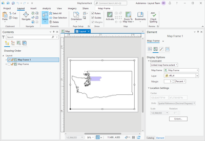

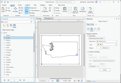

You can do this! Add an additional map frame pointing to the same map, then set the linked map frame extent constraint with the layer option set to the group layer (Learn more about map frame constraints here: https://pro.arcgis.com/en/pro-app/latest/help/layouts/customizing-your-map-extent.htm). Now your new map frame will show the group layer boundary each time while updating with information on the parcel and you can turn off the original map frame (needed to run the map series). You can use an extent indicator to further highlight the parcel if you want.
Set up:
Second page:
