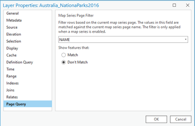

AubriOtis
You can use page queries to do this! A page query will update for each page in the map series. Any layer can have a page query as long as the layer has an attribute the corresponds to the name of the map series page. With a page query you can choose to show only the data that matches that attribute or the data that doesn't.
So if I had a map series going through all the counties in a state, I could add a layer that symbolizes all counties with a gray tint. Then I apply a page query to that layer to draw only the data that doesn't match the map series page name. This draws the tint over every polygon except the one for the current map series page, highlighting it.
You can learn more about page queries here: https://pro.arcgis.com/en/pro-app/latest/help/layouts/page-queries.htm

AubriOtis
Cheers,
Aubri
