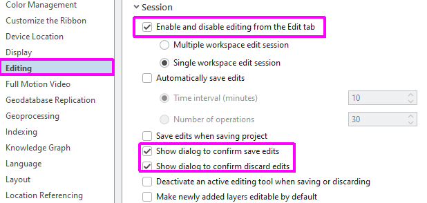

Saving a project is not the same as saving edits on data.
These are the settings I use.
I enable Editing as required and when stopping the session, and I've not saved everything, it will ask me what to do.
Add the Enable Edit and Save button in your Quick Access Toolbar - that way they are always visible.
There are issues with editing in a multi-workspace session in some versions of Pro hence using single workspace sessions.
