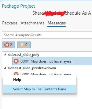

Dusted off a project from a few months ago. Pretty minimal interaction - fixed some broken paths in preparation to share as Project Package (ppkx).  Hit Analyze and Errors emerge -  "00001 Map does not have layers".   The errors are not really the issue.
 The errors referred to maps that are NOT present in the Catalog.  I cannot find them, delete them, open them via the catalog.
I can click "Select Map in The Contents Pane" and the map opens up.
I strongly suspect it's because upon opening the project today, I had to agree to format it for Pro 3.0.2 (my current version). This project was created and save in Ver. 2.  I've never seen this before.  Seems to be a bug?
